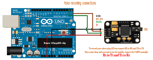

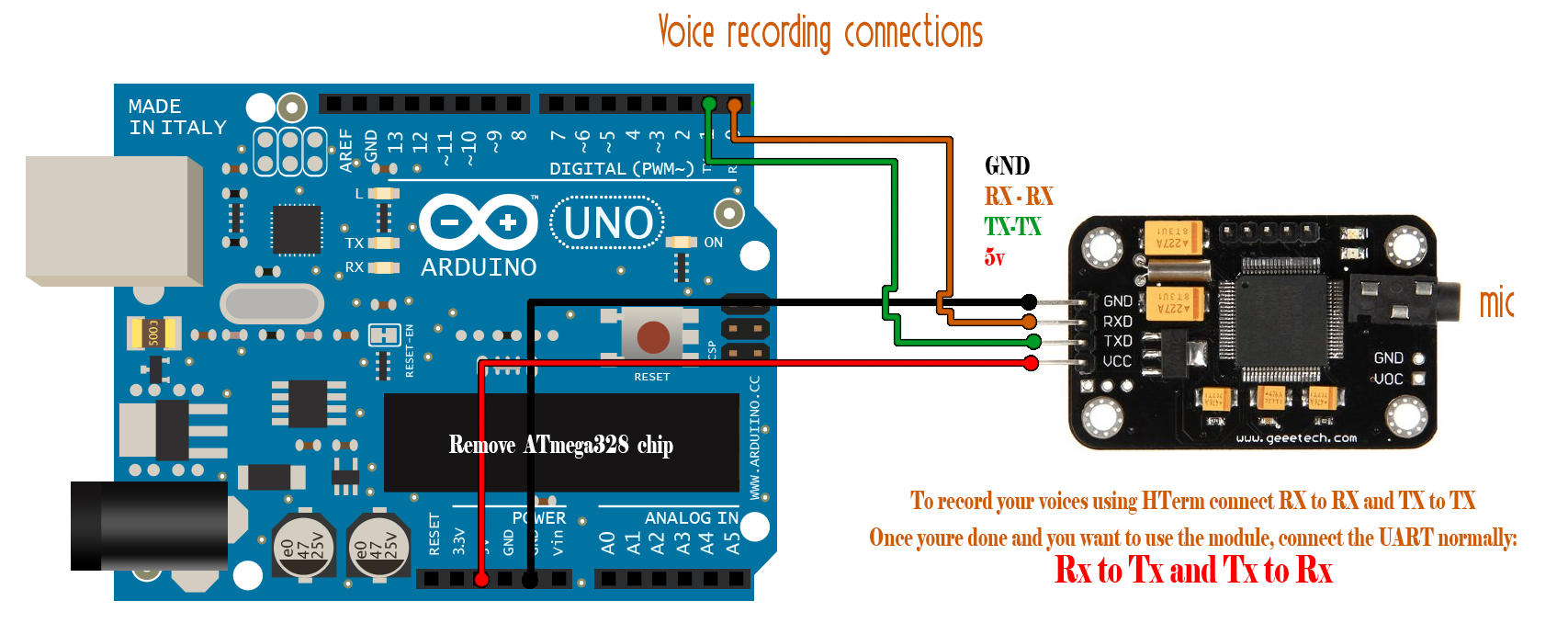

im using Geeetech® Voice Recognition
here s the manual http://www.geeetech.com/wiki/images/6/69/Voice_Recognize_manual.pdf
here s the photo of it
