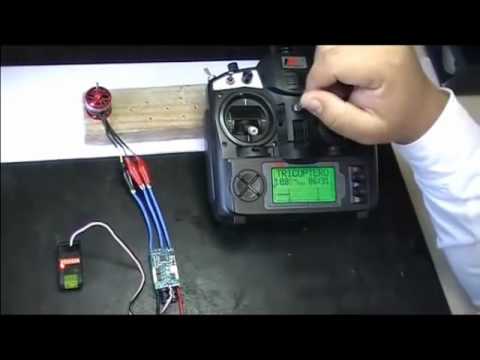

I can't read spanish so I might be wrong about this, but this seems to illustrate that 50Hz response isn't that great? Not saying that it's impossible to fly, but the 400Hz looks much better.
yutowatanabe:
https://www.youtube.com/watch?v=6EM7Xx3QEE0
Theoretically, being able to respond infinitely fast is the best way to run things, but there is a practical limit to what will be effective on the motor end, and the law of diminishing return comes into play. I think it's probably advantageous to go to the highest rate you can, but I'm extremely skeptical at the value of going really fast with it, and I know for a fact that 50Hz is fine in many situations.

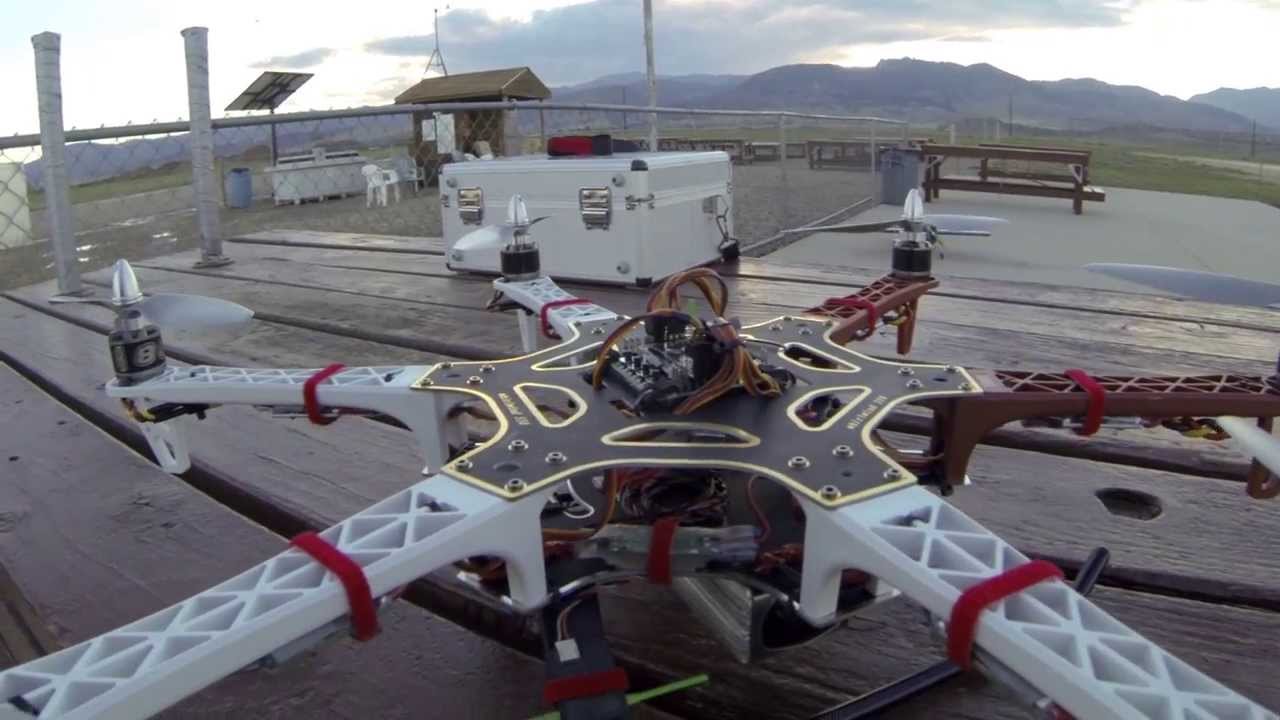

Here's videos... tell me if you don't think these are stable enough. Keep in mind, my dumb ass is flying them :slight_smile:
This one flies better after I tuned it up, but it's fine with no tuning at all. The APM hex-copter is almost exactly the same but it has DJI ESCs instead of Afro.
