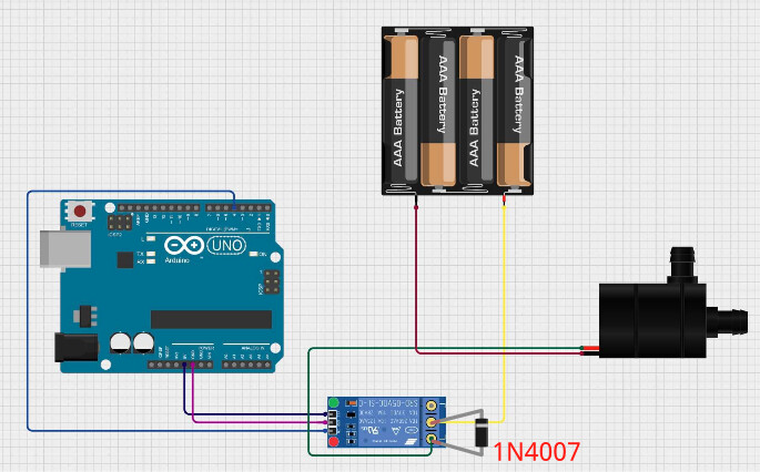

Hi, I recently started my adventure with arduino and for one of my first projects I decided to make a plany watering system. However, I encountered a problem while creating it. The issue is that when I have the whole system connected and I fire off the code that changes the states of the pin in a loop along with a delay, the relay sort of bypasses the delay because it shuts off momentarily when turned on. When the relay has no load, it works flawlessly and turns on/off every two seconds. There is also no problem with operation when the only part of the code is to set the pin to a low state to turn the relay on, then it also works without a problem. As for the relay, it is the SRD-5VDC-SL-C (it a module from here: [Buy Relay 5V 10A/250VAC Botland - Robotic Shop](https://botland.store/relays/8463-relay-5v-10a-250vac-5904422300517.html)). I have included the schematic diagram in the attachment (an arduino is powered from a computer by the usb). What could be the reason for this behavior?
 ![IMG_3667](https://europe1.discourse-cdn.com/arduino/original/4X/7/7/7/777d045c42afa0e1f39a19dd118064764b503e74.jpeg)

@kraszor
Your diagram shows the relay connected to pin 4 but you sketch uses pin 5.
Which one is correct?
<div class="post-metadata">
**Author:** ![kraszor](https://avatars.discourse-cdn.com/v4/letter/k/90ced4/32.png) [@kraszor](https://forum.arduino.cc/u/kraszor)\
**Post date:** [March 3, 2024, 12:12pm UTC](https://forum.arduino.cc/t/problem-with-relay/1231039/8 "2024-03-03T12:12:49Z")
</div>
It should be connected to pin 5

Try putting a diode across the relay contacts like this
 ![image](https://europe1.discourse-cdn.com/arduino/original/4X/4/7/a/47abe3253ca736ea0d970bd8747c3e35ae30a98a.jpeg)

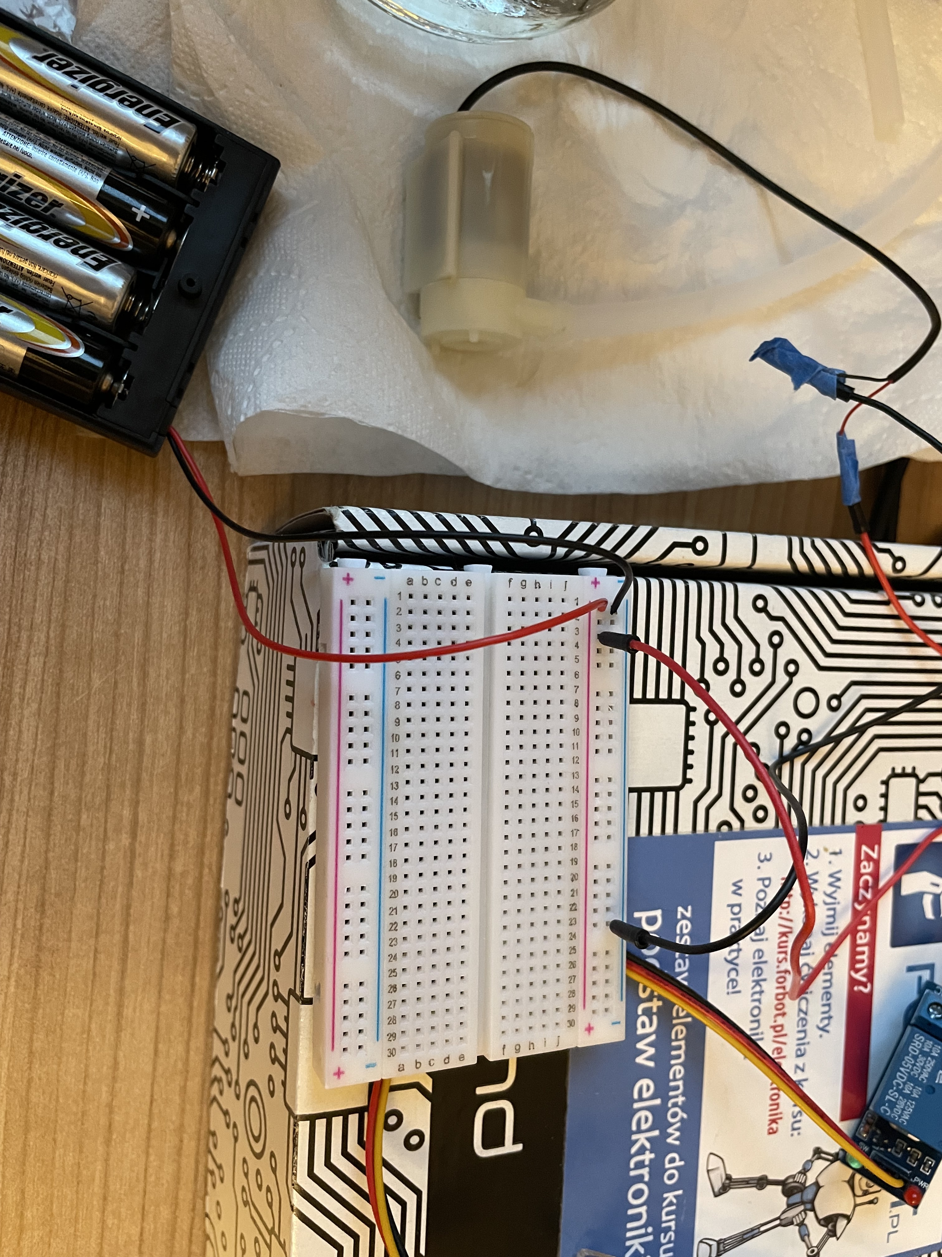

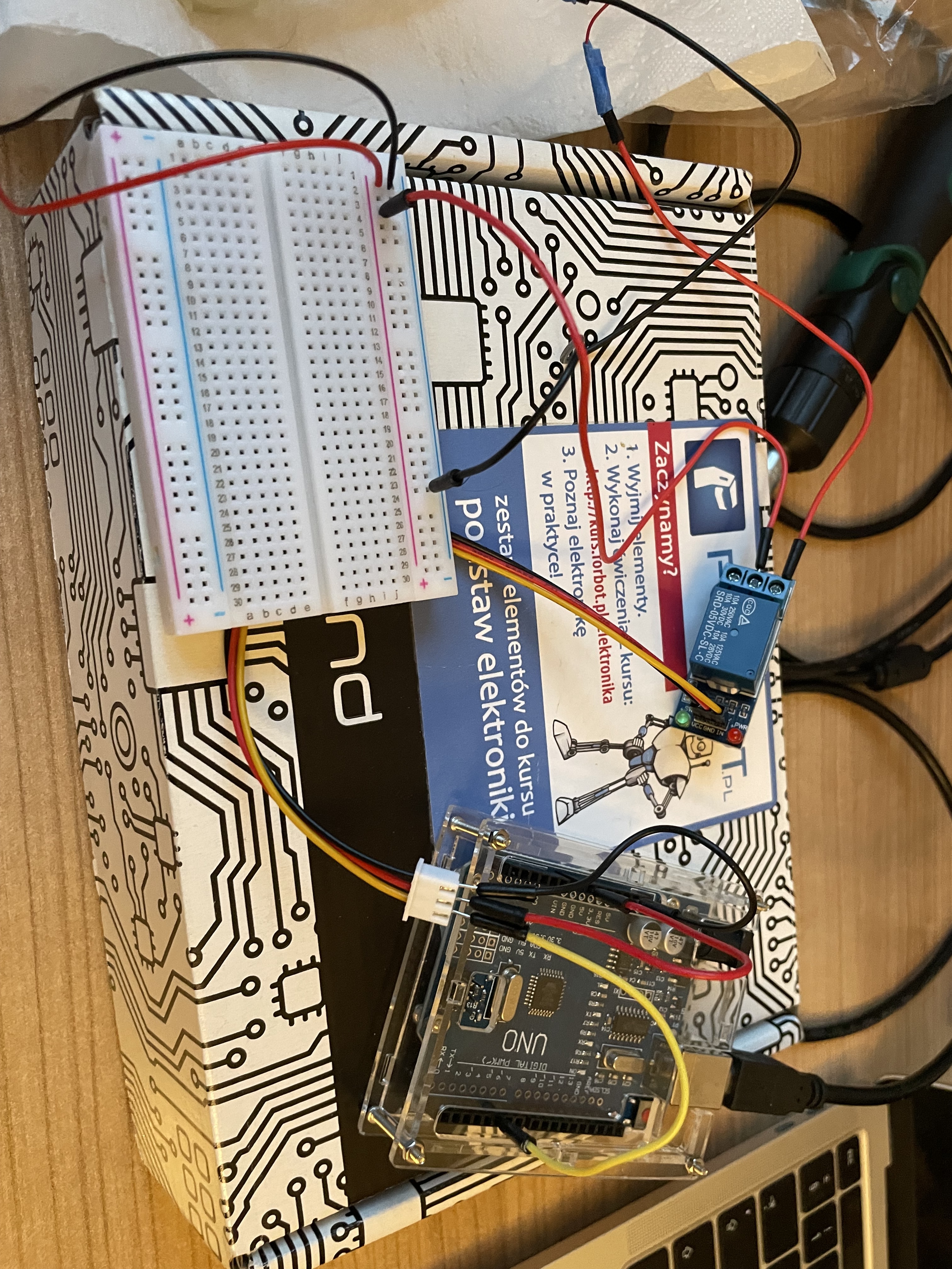

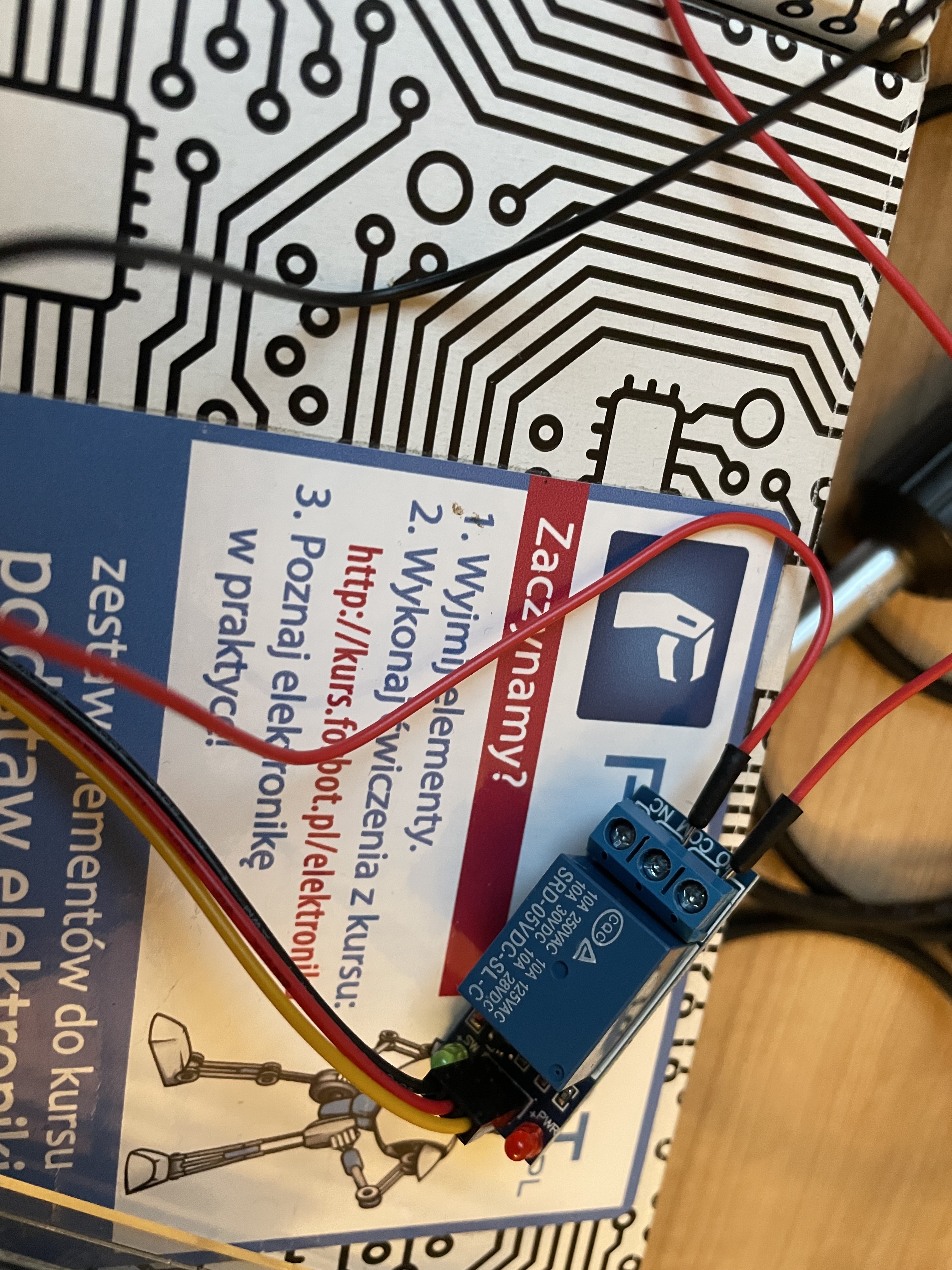

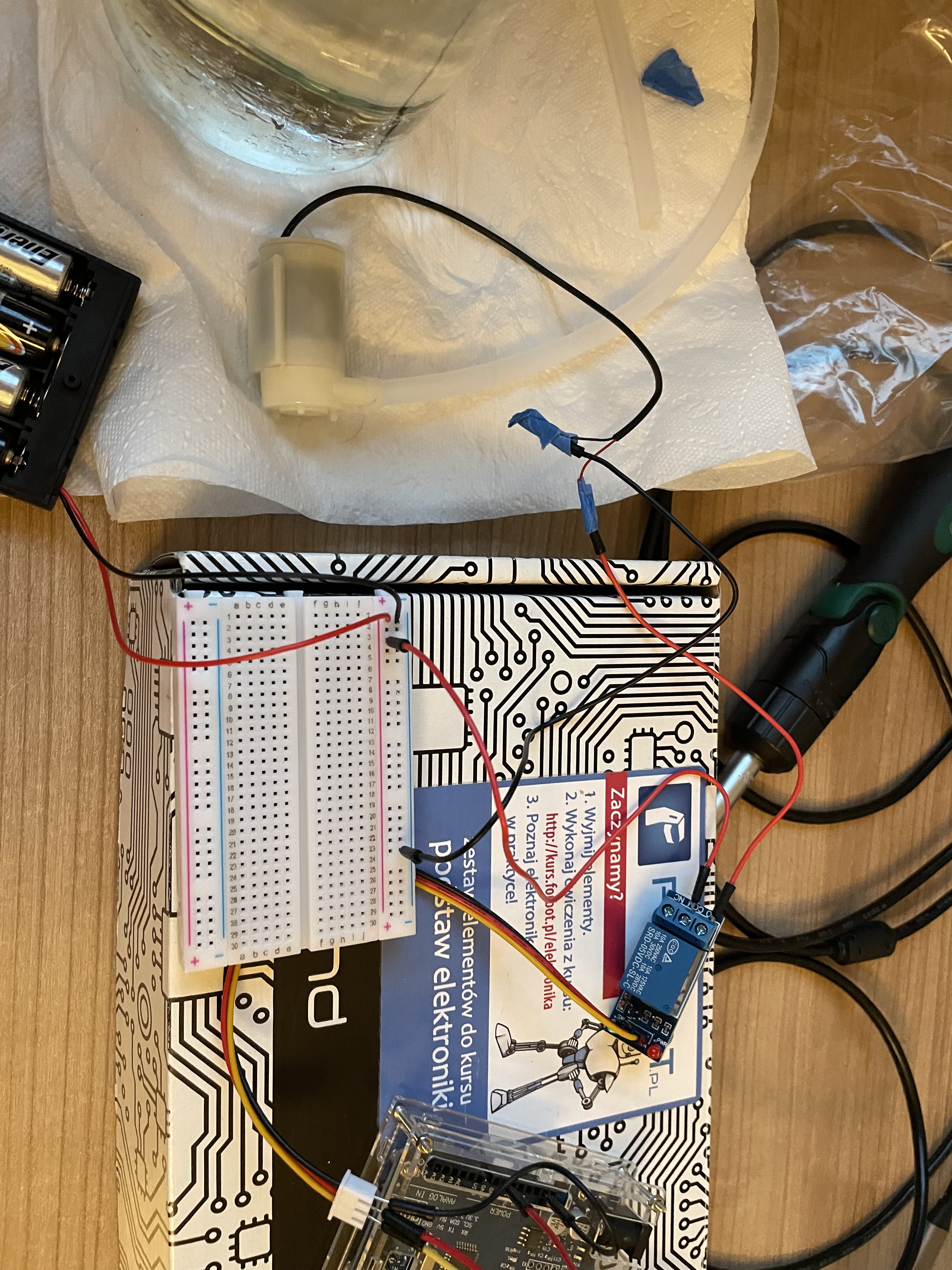

@TomGeorge @PerryBebbington
Uploading: IMG\_3671.jpeg…
 ![IMG_3672](https://europe1.discourse-cdn.com/arduino/original/4X/2/a/0/2a09b99fc7cecb8c7d4300aefa9f10fa012cc448.jpeg)
 ![IMG_3673](https://europe1.discourse-cdn.com/arduino/original/4X/8/2/d/82dbf73ffddb826d0a038b4b47b624d7c1ea4206.jpeg)
 ![IMG_3674](https://europe1.discourse-cdn.com/arduino/original/4X/a/2/c/a2c2dc62f97128f430dc73631ce22421884ca30f.jpeg)
 ![IMG_3675](https://europe1.discourse-cdn.com/arduino/original/4X/2/c/4/2c413dbcb16cbe14d06630ba7c05e098c682364c.jpeg)
The load is this pump or very simmilar: [https://5.imimg.com/data5/IQ/GJ/PF/SELLER-1833510/dc-mini-submersible-water-pump.pdf](https://5.imimg.com/data5/IQ/GJ/PF/SELLER-1833510/dc-mini-submersible-water-pump.pdf)
**Post date:** [March 3, 2024, 4:26pm UTC](https://forum.arduino.cc/t/problem-with-relay/1231039/19 "2024-03-03T16:26:29Z")
</div>
Yes, I have a DMM
**Author:** ![PerryBebbington](https://dub1.discourse-cdn.com/arduino/user_avatar/forum.arduino.cc/perrybebbington/32/238766_2.png) [@PerryBebbington](https://forum.arduino.cc/u/PerryBebbington)\
**Post date:** [March 3, 2024, 4:37pm UTC](https://forum.arduino.cc/t/problem-with-relay/1231039/20 "2024-03-03T16:37:39Z")
</div>
Thanks for the photos.
At the moment I don't see anything that causes me concern, so I am going to watch this topic and see what others suggest, but at the moment I don't have any ideas for you to try. If I think of anything I'll be back.
