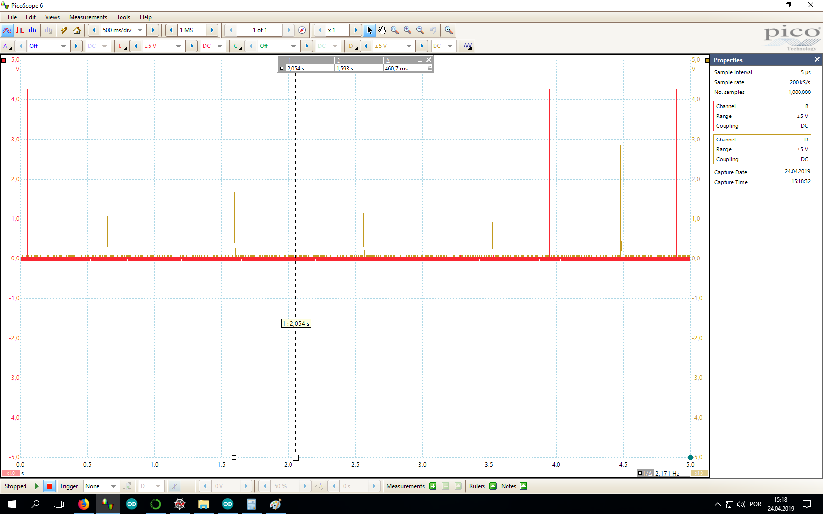

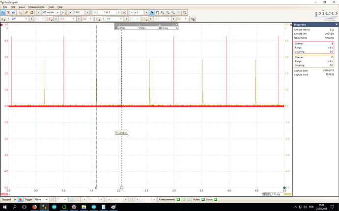

The problem is remaining: i'm not able to delay my pulse in the amount of time I want and as @gfvalvo said in a thread before, probably the FIFO structure is not a good solution for me. I'm trying to figure out how to do it. Do you have an idea how i could solve this?
Resuming the problem: I have 2 Arduinos connected to 2 separate oscillators. The oscillations which depends on the discharge of a capacitor occur at a rate of 1Hz. What I need to do: after my Arduino capture this discharge(spike on the oscilloscope), I need to generate a pulse of 60us width and this pulse must be delayed by certain amount of time (this value comes from Python). Until 1s delay I am on the first period, but if I choose around 1,5s, we are on the second period and my system must ensure that it can store previous spikes in orde to generate the delayed pulse later.

I still dont get the result I want. Maybe it's something with timers. From what I could study, my setup is correct. Could you help me if you know something about it ?

On attachment is the figure. The red pulse should be delayed in 1s (15625 corresponds to 1s)from the yellow one (check delta value ) but it is 460ms.
