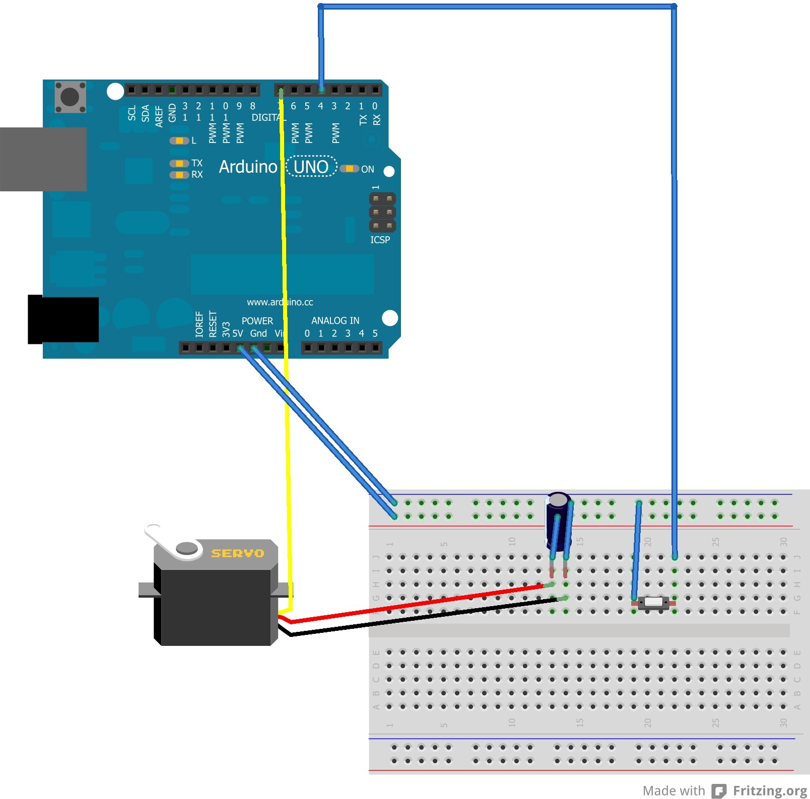

ok, it's a new code, when I push the botton, the servo go to 90°, but when the botton is LOW the servo it's crazy...

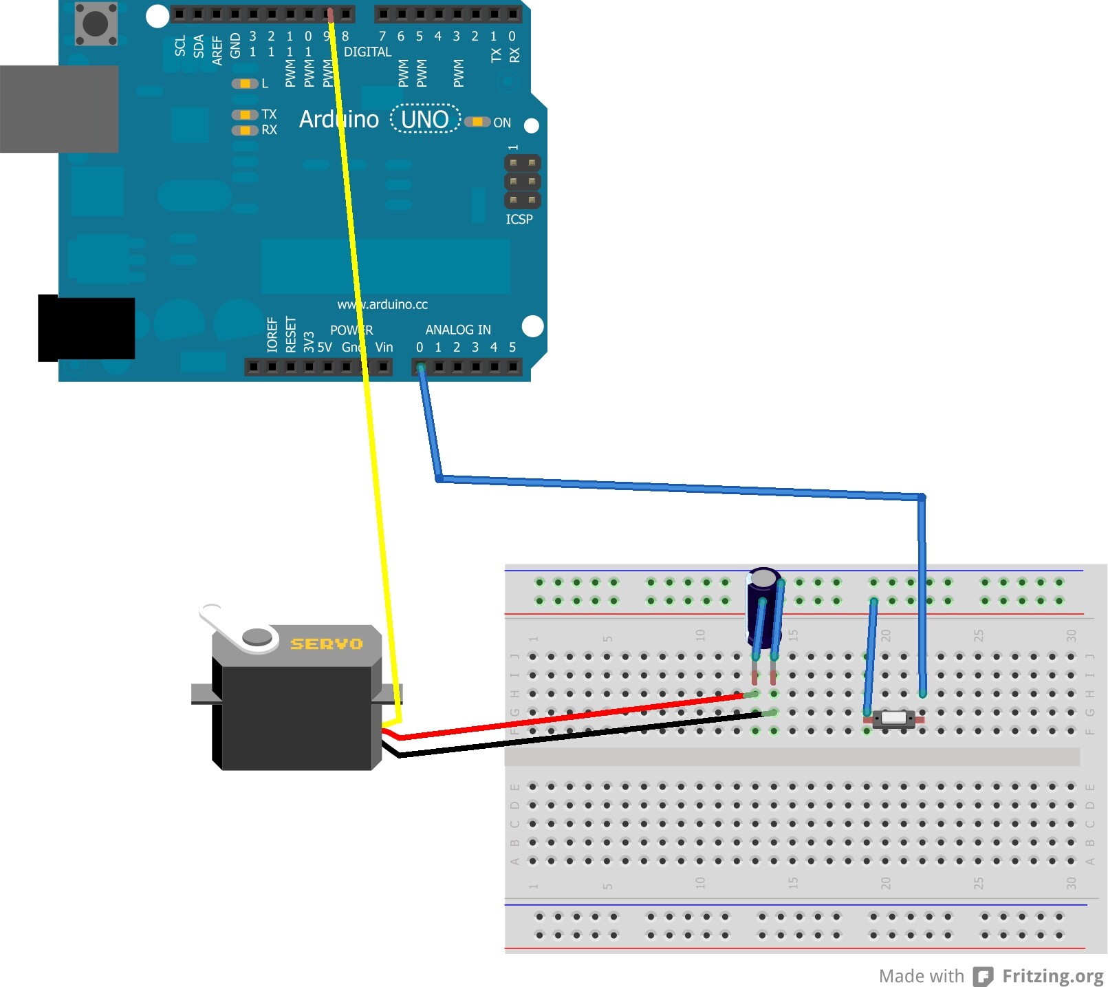

"LOW" is a description normally reserved for digital inputs.
How is your button wired?
thank you zoomkat, it work perfectly! I understand.
this is a new schema.
