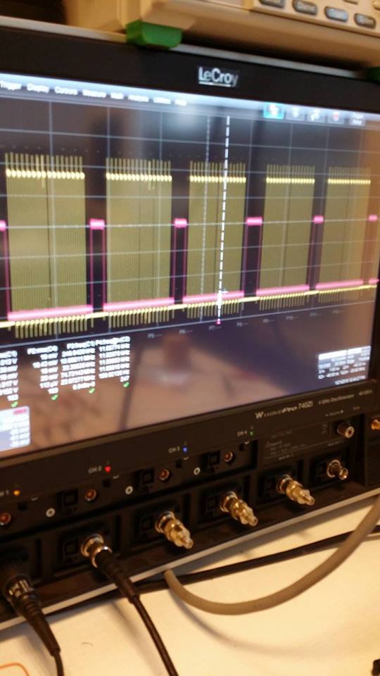

it is the same problem when i wrote "Serial.println(data);" there is a problem with the clock and cs like before :(, i read somewhere that if serial.println() doesn't get a value to print, the program may stop working, that what i think is happening, the serial monitor showed the value "0".

here is what the oscilloscope shows before commenting the serial.print(data) then when commenting it
in yelow it's the clock signal , in pink it's de cs:
here is another pictures of the behavior of the clock and cs before commenting and after commenting the " Serial.println(data);" line
and also here is what i get before commenting and after commenting the serial.print(data) it's what the adc sends it's pin 12 (the miso pin)
