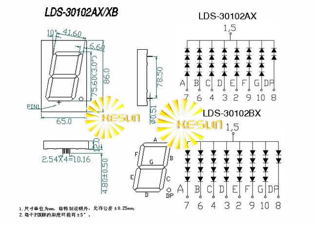

I'm trying to drive a 7 segment giant digit that works at 12v with an Arduino and some TIP120.
My idea is for the arduino to control each TIP120 to turn on/off each segment.
The digit as a common anode (negative pin) for all 7 segment, so each TIP120 will have to drive the +12v (positive).
I have a small power supply that convert 12v to 5v and 3.3v, that will power both the Arduino(5v) and the Digit(12v).
I have tested each segment, connected to the emitter of a TIP120, the colletor to 12v, and the base to 5v... it works fine.
But wen I plug the base to an arduino pin (set to HIGH) nothing happens...
I know the pin works since it turns on a simple LED + resistor...

Looks like you are trying a cct. similar to above i.e. Q1 where Q2 would would apply.
I have tested the Q2 cct, and it still does not work.
If you have the 102AX, it is common cathode.
To be honest I'm always mixing cathode and anode. So to make it clear to make any segment work, I have to single pin that I connect to GND and every other pin has to be connected to +12V (each pin for each segment)

A TPIC6B595 can only be used with a common anode 7-segment display.
The 12volt is connected to the common anode, and the seven cathodes are connected to the outputs of the 595, with seven current limiting resistors in between. There is an eight output for the optional DP.

You are trying to use the TIP120 as an emitter follower - however you cannot get any voltage gain that
way, so it cannot level-shift upto 12V, the LED display will see perhaps 3.5V at most, due to the base-emitter drops from 5V at the base of the TIP120. Thus the display does nothing.
If using an emitter follower for switching you will waste a lot of power in the transistor, its not efficient -
common-emitter circuit is the one to use, and for high-side switching you need to level to shift to 12V first,
then use a PNP transistor in common-emitter configuration to actually switch the load. Typically that means
needing two transistors.

The only inscription on the display is: FJS30101AH.
I have checked my order detail and it says: Cathode 30101AS.

With common cathode you require PNP or p-MOSFETs to switch the 12V high-side, and a small-signal NPN transistor as a level shifter. The BC337 could be an NPN level shifter.
AS = common cathode.
