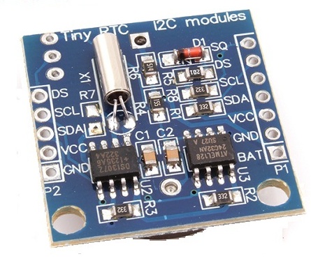

problem writing to DS1307
Im just using the standard code that comes on the Arduino software just to set the time. Iv done this before with another arduino board and DS1307 chip and it worked fine.

Thats the code that i am using to load the information into the DS1307. Iv got SDA connected to A4 and SCL connected to A5 and then 5v and gnd connected to VCC and GND.
when i run this code and i run the Serial Monitor it comes back with 165/165/165 45:165:165.

so after running this little program and then running the Serial monitor it came up with the following:
"I2C scanner. Scanni address: 80 (0x50)
Done.
Found 1 device(s).
ÒZÿà§l"
iv tried changing the address to 0x50 to see if thats the problem but im just getting nothing back from the little DS1307. Iv no idea what the problem is at the minute or how i can get it to read/write to it.

Which DS1307 hardware are you actually using?
Circuit schematics?
Did you make a DS1307 module of your own?
You are telling nothing about the DS1307 circuit schematics, so I make a guess:
Are you possibly using one of those shitty modules labeled "Tiny RTC"?
Picture:
Or what?
Those shitty "Tiny RTC" modules have TWO I2C devices on board:
1.) DS1307
2.) EEPROM 24C32
When running an I2C scanner sketch with that "Tiny RTC" module, you'll find the EEPROM 24C32 at address 0x50. An EEPROM is NOT an RTC!
As jurs says, the i2c scanner has found the eeprom on the bus, but not the ds1307. It should be at address 0x68. You have a defective module or chip.

yes sorry this is what i am using and i thought the chip may of been defective so iv ordered another one. It was just easier then building my own if im honest and there so cheap. plus the last one i used worked fine.
I ordered this little item from www.dx.com.
i could build one my self but its just more hassle and messing about maybe when i have more time i will. Ill check for shorts on the chip and try find out what wrong.

These "Tiny RTC" modules circuit has big problems with the battery backup and keeping the battery backup voltage in the correct range:
  • sometimes it is equipped with a standard battery cell instead of a rechargable cell
  • sometimes the voltage of the rechargable cell is too low ==> circuit will not work
Please take out the battery and look up the exact battery type: What's printed on the battery?
Do you have a multimeter with voltage measuring range? What's the exact voltage of the battery when outside the circuit?
If the problem is an empty rechargable cell, it may help:
  • keep the circuit connected to VCC 5V and GND for several hours to recharge the battery.
If the circuit doesn't work after some hours of recharging, you better try to obtain another RTC module. A better choice would be a DS3231 module.

craig20102010:
battery has some Chinese writing on it then it says lithium battery cr2032 3v
Wrong battery, I think.
If I remember correctly, the "Tiny RTC" circuit contains a charging circuit and requires a rechargable battery.
Wrong: Lithium battery CR2032, nominal voltage 3.0V
Correct: Lithium rechargable battery LIR2032, nominal voltage 3.6V
Ah right. And this would stop the unit from writing to the chip or at least ruin the data coming from it?
The voltage on the current battery is 3.4v so it's in good condition.
Checked the headers vcc, gnd, sdc, scl to the correct chip pins and I'm getting 0 ohms resistance so it's all good for connections to the chip.
All the components are reading some sort of resistance relevant to what they are apart from the crystal? Not sure if that should be showing open circuit or not.
