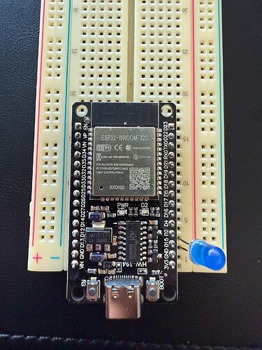

I trying to get Taylor Galbraith HomeKit LED project to work on a ESP32-Wroom-32D. It keeps giving an error on "text section exceeds available space on board".
From the specs it says it has 4mb spiff flash memory.
I am a beginner on this so looking to understand and learn.
Thanks Robert

For the ESP32 Dev Module, what memory model did you select?
so 4mb is 4000000 bytes right so why is the maximum 1310720
Different memory. You need to pick a bigger memory model for the sketch. I usually just pick HUGE. Its in the IDE menu, so go find it.
As mentioned I am absolute beginner in this, you mean I need to change the Board in IDE not the actual esp32 module.

Looks like the sketch now get accepted only one other error
But that is an upload error, and it's one I haven't seen before. It appears to be caused by a bad cable or a bad connection, but in any case, your original problem is solved, so mark post nine as the solution.
You should really start with much simpler projects. Do you have a copy of the Arduino Cookbook? Work your way through that from front to back, and then you might be ready for IoT stuff.
Set the upload speed slower and it looks it worked
