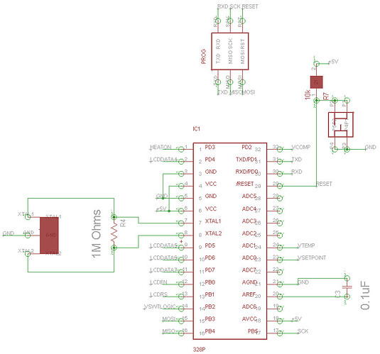

I’m having extreme difficulties programming my newly bought blank Atmega 328p-au TQFP chip that I’ve mounted on a PCB.
The PCB is not fully populated at this point, just the MCU, reset pull-up resistor, resonator and wires for the i/o programming and power lines.
So effectively all that’s in the circuit is:
Atmega 328p-au TQFP chip (Farnell order code: 1715486):
Pin1,2,9,10,11,12,13,14,19,20,22,23,24,25,26,27,28,32: Not Connected
Pin 3,5, 21: Ground
Pin 4, 6, 18: +5V
Pin 7: XTAL 1
Pin 8: XTAL 2
(these pins are connected together via a 1M resistor and then to a 16MHz resonator with 3 pins, central connected to ground, other two pins connected to 7 and 8 of MCU. It has internal capacitors so no need for externals, according to datasheet! http://www.farnell.com/datasheets/95544.pdf )
Pin 15: MOSI
Pin 16: MISO
Pin 17: SCK
Pin 29: RESET (connected to RESET header pin and then via a 10k resistor to +5V)
Pin 30: RXD
Pin 31: TXD
I’ve checked all the pins and outputs with a multimeter continuity check and everything appears fine, no dry joints or short circuits, all pin to pin resistances are as low as expected and resistor values correct.

What were TxD and RxD connected to? Up to this point, you made not mention of a USB-to-serial converter. Without one or at least a serial connection to the PC (for which you would need to do level-shifting), you can't upload a sketch via the bootloader. However, you can instead program a sketch via ICSP, using the same connections you had when uploading the bootloader. You just need to select "Upload using programmer" in the menu. This is how I upload sketches on boards I build - I never use a bootloader.
Russel77:
I then tried with a standalone USB to serial board (http://onecall.farnell.com/ftdi/mm232r/development-kit-usb-uart-module/dp/1146037), after loading the bootloader with the above system. I connected up the board to give a 5V output (confirmed with multimeter) and then connected the RTS pin from the serial board via a series 0.1uF capacitor to my reset pin, and the serial TXD and RXD to the MCU’s RXD and TXD respectively (I also tried it the other way round on the off chance, it gave the same error).
I think the Arduino upload code is designed to pulse DTR, not RTS. Alternatively, you can use a reset button and press it at the right time.
Your ceramic resonator is fine, I use them all the time. The 1M resistor is not needed, there is already one in the mcu.

Here's a picture of what's currently connected, any pin without something on it listed in the first post is still not connected, the rest of the board is unpopulated, but the reset switch has now been attached.

dc42 you are my hero, after much faffing about I realised that what I thought was an error was actually it blinking back to me... it's been a long night!
So I got it to work in the end by programming the Arduino with the ArduinoISP sketch, connecting up all the correct ICSP as before then putting the capacitor over the reset and then selecting programmer as Arduino as ISP, then doing what you suggested and just clicking on upload using programmer.
I've tried it with a few different options and it works fine so this is the solution, using the program as it was intended still doesn't work but I don't care so long as I can program :slight_smile:

I'm glad you got it working. If you are programming via ICSP, you don't need the capacitor on reset or a reset button, just the pullup resistor to +5v. And if you're ever near Ash Vale, UK then you can buy me that beer!
