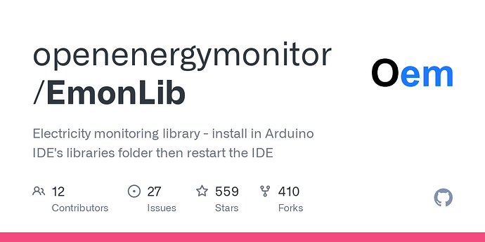

@0x29a
You can measure AC with the ACS712
Use this library to calculate power
Hi, @0x29a
Do you need instantaneous power of RMS power?
AC Power is usually RMS power, so you need to use RMS Voltage and RMS Current.
Thanks.. Tom... :grinning: :+1: :coffee: :australia:
@0x29a
The EMonLib will give you the following:
-Real Power
-Apparent Power
-Power Factor
-RMS current
-RMS voltage
