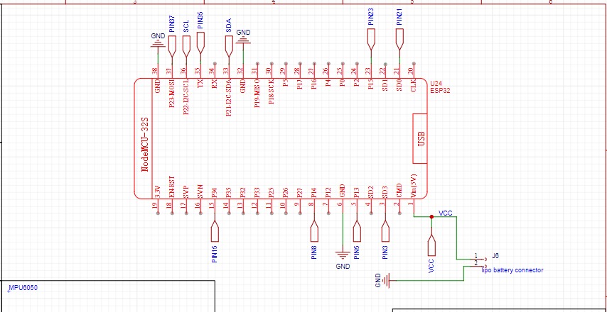

High I'm working on a new project (Esp32 WiFi based Drone ). the drone is supposed to use the esp32 build in WiFi to connect with a mobile which works as a controller to drive the circuit. and i'm encountering three major problems. i'm encountering three major problems.
The pin14 on my esp32 is high even when initialised to zero. I thought the problem was in the pin. so i tested it but the pin is working fine. i used the led blinking method.
The motors on my drone are running without even uploading the code the moment i connect the battery or if i connect the esp with a USB the motors start running. i'm using SI302 MOSFET. i ruled out that the problem might be in the MOSFET, by replacing them with new ones "did not work".
The third problem is that i'm building this project on a PCB and when i connect the esp32 (while mounted on the PCB) with the computer it does not show up on the computer. but does show up if not mounted on the PCB.
i"m using esp-Wroom-32. here is the schematic for the circuit.
this is the code I'm working on.

I'm new at this so i would appreciate it if i could get some help on this.
