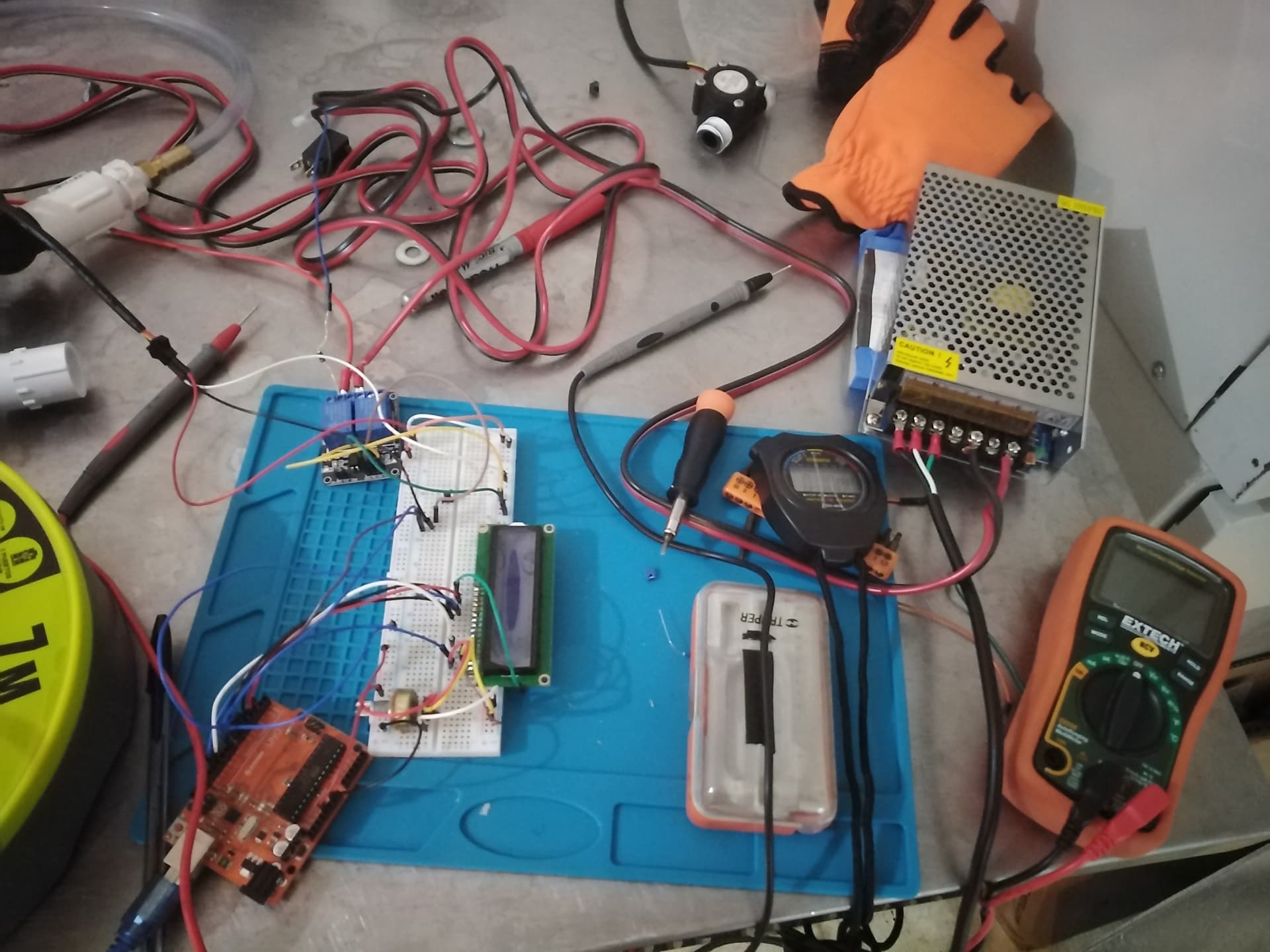

Hello fellas, I write this looking if I can get help for a project i'm making.
I wanna make an automatic liquid filler where you can input X liters to dispense, and the basis for measuring volume will be a hall effect flow meter (YF-S201 in my case).
So, as a first major step I wanted to dispense exactly 1 liter, but I've ran into a hair pulling problem, the sensor, according to the datasheet, sends a certain amount of PWM pulses depending on the flow, measuring the flow of my pump manually, I get around 4.3 Litres per minute, however the output pulses of the sensors are all over the place, for the flow I measured, I should be getting around 40-50 pulses per second. On this pic I recorded some pulses per second readings on the serial monitor, and as you can see, they're definitely not lining up to the real flow.
REgistry2
This makes the arduino code detect a liter way faster than intended, making me only get about 400-700 ml of real liquid served.
I've already tried several code approaches to measure water flow through the flow meter pulses, and I also doble checked all my connections. I tried to buy a replacement flow meter, but the problem persists, so i'm all out of options here.
Here is a drawn circuit diagram of my project so far, hope it helps, also, here is one of my builds, it's messy for now, wanted to make it a lot more clean once I get it working.

I suspect that the flowmeter output may be open collector. That means that there needs to be a pullup on pin 2 ( the sensor pin). Try the internal pullup (pinMode INPUT_PULLUP).
pinMode(PinSensor ,INPUT_PULLUP);
Put a serial print in to display the number of pulses per second before any math.
There needs to be a driver for that relay coil and a flyback diode or you are likely to lose pin 8.
Your button pin has the internal pullup enabled, but, in the schematic, is wired to Vcc with a pulldown resistor. What is it?

Sadly I tried INPUT_PULLUP and results are still the same.
I did put a flyback diode parallel to the water pump, it's the little thing besides the square saying "PUMP" on the drawing.
Oh and about the PULL_UP on button pin, sorry, that was something I put back when I simulated a button by having a jumper connecting button pin and ground, and when I opened it, it would take it as a press, already removed it from the current versions.

How consistent is the flow, does it pulse?
In other words is the pump a circulation type pump or a pulse type pump?
You are using an electric pump, it has a magnetic field, keep it as far away from the flow sensor.
Also keep its power supply wires away from the control and sensor.
Here is the manual; TTL output.
YFS201manual.662398285.pdf (143.2 KB)
Are you drawing water from a container then letting the outlet of the flow sensor back into the container?
Have you got the water flowing through the meter in the right direction?

If that is what you want, which is far from clear, I suspect your flow meter is inapprpriate.
While the RATE is all over the place, the overall QUANTITY at 4.3 l/min with that sort of sensor can be very good - within 1% of a big buck commercial unit - measured over 300 litres. This implies that the average rate must be pretty good too.
For short bursts, you might be better off with a Swissflow sf800, which I think has 6200 pulses/litre.
