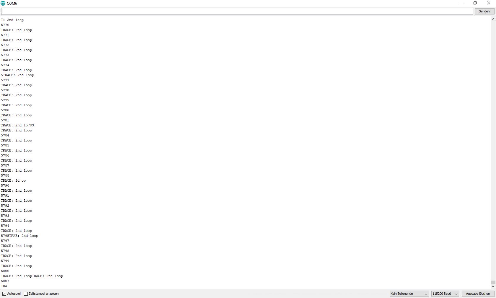

I am facing problems with for loop in my code . The loop is supposed to run some 7400 times but it suddenly breaks after 5807 times. My first guess is that there is some where a overflow. Please find output in attachments.

Which processor, chip, or board are you using are you using? The 45k in the two arrays in RAM might be too much.
I am using arduino due board . I tried to run the C code on STM microcontroller it working there but i don't know what's wrong with arduino due board.
Could it have something to do with the fact that you are creating 135 Kbytes of arrays on a processor with only 96 Kbytes of RAM? And you're putting 90 Kbytes of arrays on the stack? And the Due RAM is "banked", with 64 Kbytes in one bank, and 32 Kbytes in the other? And you're using memset to "clear" the arrays, and memcpy to copy/move the arrays, which is likely wiping out most/all of your RAM?
Other than that, I see no problems at all...

    float filteredY[SAMPLE_LENGTH];
    float avgFilter[SAMPLE_LENGTH];
    float stdFilter[SAMPLE_LENGTH];
On the stack?
Your going to have to offload this to.. Possibly files on an SD card?
-jim lee
Or, use the Wemos D1 mini which has 4mb of RAM.
