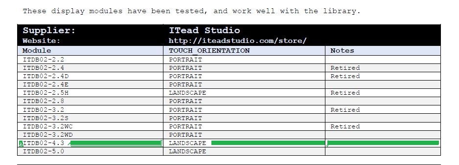

The first thing that immediately strikes me is line 6 of your code, line 21 of the Henning original
// Define the orientation of the touch screen. Further
// information can be found in the instructions.
#define TOUCH_ORIENTATION  PORTRAIT
Did you notice the comment about more information in the instructions????? :wink:
If you had read those instructions you would have seen your problem!

I tried that and still the same.. the Calculator url reports the same. :drooling_face:
The calibration results cannot possibly be the same if you have changed your touch orientation to landscape in the cal sketch. Supply your new results please.

Hi dex,
Something does not make any sense.......... even if you had run the calibration with the correct orientation, it is EXTREMELY UNLIKELY(impossible) the CAL_X CAL_Y results would be the same and I can absolutely guarantee your CAL_S would NOT be the same! So my question is, exactly what do you think you have done?
Sainsmart are renowned for including badly modified versions of Hennings libraries, and if you did not delete those before you installed the genuine libraries, it is highly likely you have conflicts.
I would suggest you remove ALL versions of UTFT/UTOUCH/UTFT_Buttons, and only install the latest versions of Hennings libraries. Download them all from here :-
UTFT
UTouch
UTFT_Buttons
The only changes you should need to make to UTouch_Calibration are :-
Line 21
#define TOUCH_ORIENTATION  LANDSCAPE
Line 34
UTFT    myGLCD(ITDB43,38,39,40,41);
WHEN you have got things working right, I can tell you with certainty your CAL_S figure WILL be 0x8010F1DFUL, once you have figured out how to get that right, then I would expect the CAL_X/CAL_Y figures to be correct also!
