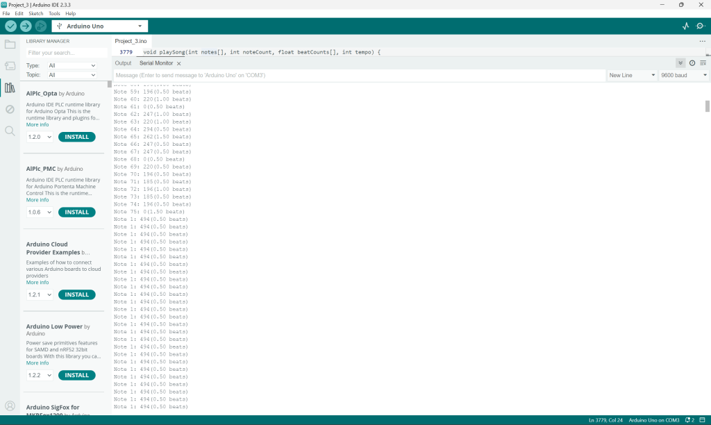

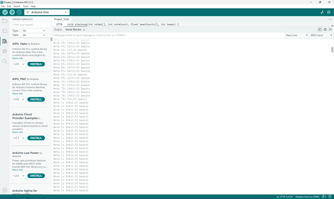

PROGMEM and Loading Songs
Basically, my project is a Piezo music player, for which I've arranged four songs for so far (Only one is shown here, however, because character limits). I ran into some serious memory issues with arranging each one for the Piezo, but I was able to get around this after some users on the Arduino Discord told me about PROGMEM.
Problem is, something's wrong with the process of loading the song back in to actually play it. According to the serial monitor, 75 notes into loading a song, the loop's index just loops back around and gets stuck on the very first index for all eternity. What's going on here?

noteCount is passed as an int to playSong but your for loop is comparing against a byte. Probably not the problem but worth fixing.
I made some major changes already since I posted this thread. I wonder if that could be why the songs loop back to start at 255 notes in.
Ok i don't know how many note your song contains, but i have some pointers.
First of all, tone(0 is a very inaccurate method of tone generation.
Second, you should put the Notes in the same variable structure, keep them together, and use some sort of terminator to keep running to the end of the song and test for that.
I have a melody player on an ATtiny13, ok there is no LCD and Serial output, but it is super memory efficient. basically 1 note is just one byte, you can modify the speed a little, and it uses note lengths, rather than exact timing in milliseconds.
You are using 6 bytes per note and float computations and all.
Eh yep, it just simply rolls over. In fact the loop never ends because of it if the number of notes is bigger than that.
Still switch to a combined struct which contains both and use a terminating '0' for the length of the note, but drop the floats for that. Floats may never be exactly equal to anything, and in fact you are just using eights, or multiples of that. I fit it in a nibble but fitting it in a byte is easy enough.
One of my songs has fewer than 255 notes, but most of them are much, much longer than that.
