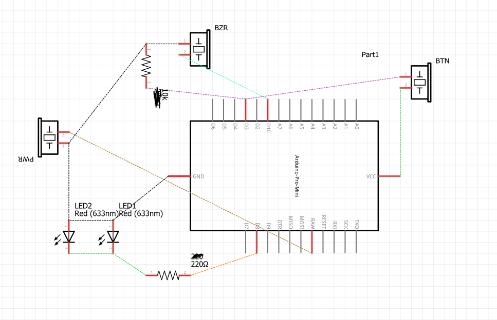

My program randomly triggers. It’s supposed to start with a button press but pressing it does nothing.

Did you mean pinMode(BUTTON, INPUT_PULLUP);?
Also change if (button_state == HIGH) to   if (button_state == LOW) if you're using a pull-up resistor.
Pieter
Hello - indeed Explain your wiring
How have you got your button wired?
TomGeorge:
J-M-L:
Does this help? https://i.imgur.com/mHbZ8OR.png
It was working on a breadboard but when I soldered it together it doesn't work correctly.
You have a floating input. Read this. Gammon Forum : Electronics : Microprocessors : Switches tutorial
Delta_G:
Thank you for your reply, is this better?
Not even close. It would probably be easier to use the internal pullups on the arduino and connect the button to be active low.

Oh, well thank you. I'm attempting to use the built in ones at the moment.
