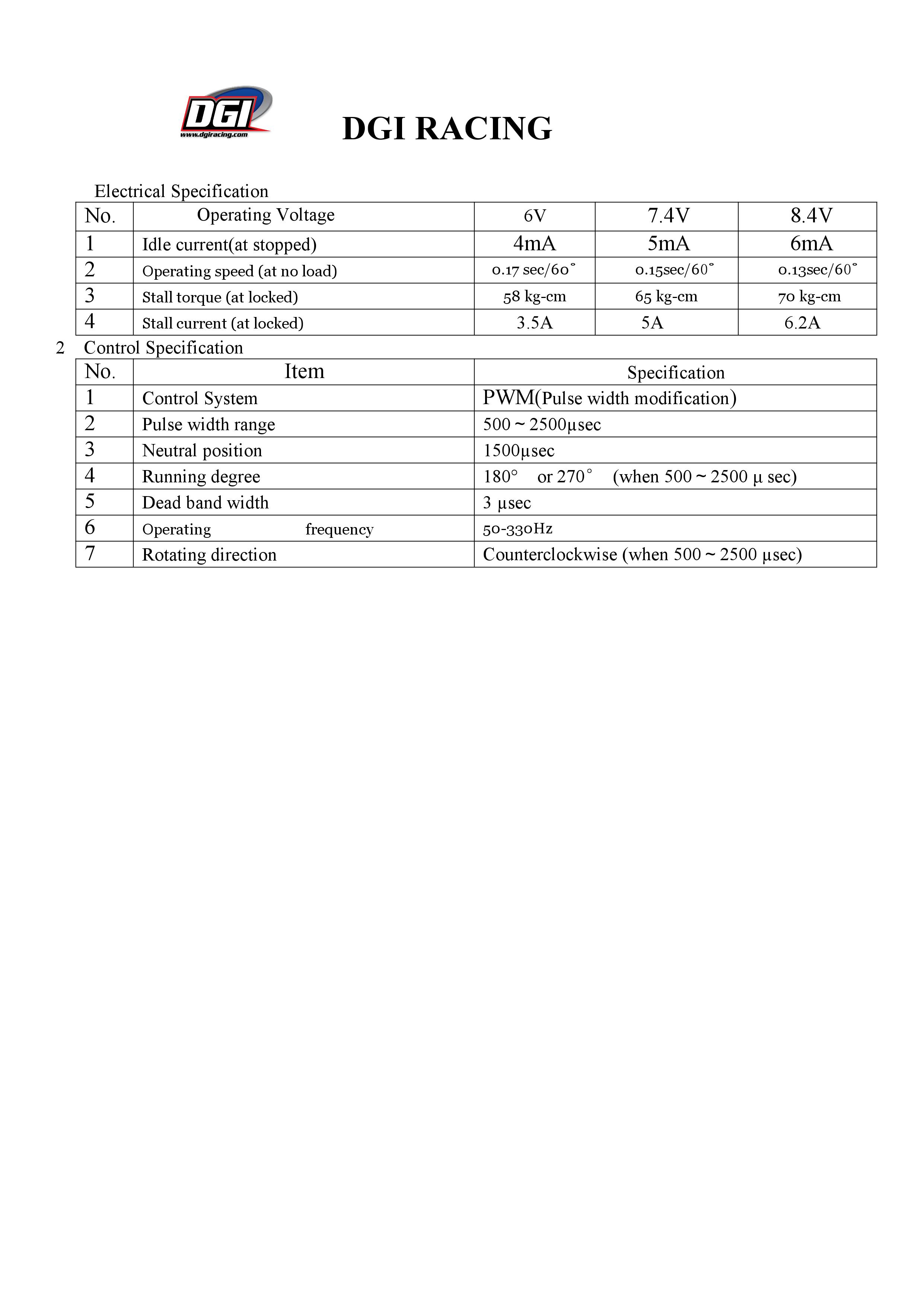

Ok. I'm learning as I go. This is the first time I've actually made it to the point where I can see it in action and the high torque servos have been rather weak.
The 60 kg servo couldn't even lift the arm in the air but I realized the current knob on my bench power supply was turned down low..
I bought a cheap one off Amazon and you have to set the voltage limit and short it but I guess I need to have the current cranked.
Its still not able to lift much but the arm has most of the weight at the end but the whole thing probably weighs 11 ounces and the arm was about 30 inches long. I also had to speed it up by making a large wooden gear (about 6 inches diameter) and a smaller one.
I'm shortening the arm and adding a counterweight.
Hopefully I can get this thing to work.

Convert those figures to SI units, work out what the torque it is exerting on the servo shaft, then compare it to the servo specs.
Can you please post a link to data/specs of your servo?
Don't forget if your gear it to speed up then the available torque will go down proportionately?

based on the above specs for a 60 kg servo, it looks like it is capable of providing 23.8 kgCm (330 ozIn) of torque but probably requires a couple amps of current

And this is the servo:
