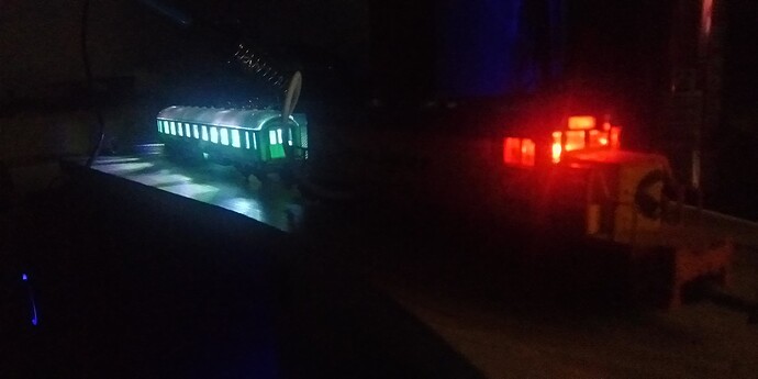

i trying to make a light train with a button witch changes the light modes from strobe light to normal light
but my program always shows an error please help o jeah and i have a usb positive in pin 12.
