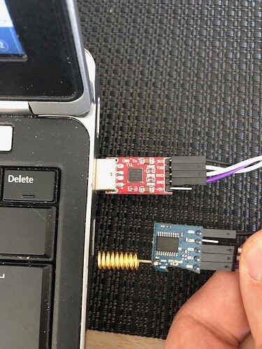

I am trying to program LORA through USB to TTL.
I connected
USB to TTL LORA
3v3 VDD
GND GND
RXD TXD
TXD RXD
I am connecting it to USB port on my laptop and I In Arduino IDE nor in HTerm I do not see valid port connectivity to open the serial monitor.
Does it mean that thie USB to TTL part is broken. Is there anything else I can do

REYAX RYLR998
The module USB to TTL was delivered with LORA module so it is meant to be used with this part
Till now all I want is to connect serial monitor to Lora to set its address and network ID and other parameters. I will be connecting it to Arduino pro mini later

Weird one. I obviously checked the cable. no help.
But I tried to connect to different PC and there it worked.
It is still not working on my primary computer but I need it only to program the Lora modules after that I do not need it anymore
