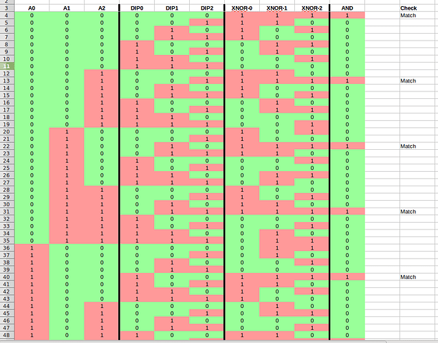

Please look at the attached diagram; here I use a quad 2-input XNOR chip, with each address line going into one side of one of the gates. On the other side, I have 4 dip switches, ON=HIGH; if off, a pull-down resistor (I only show one resistor on the diagram due to my lack of drawing skills - please assume each line has its own pull-down resistor) ensures its at logic zero. The output of the XNOR gates is then ANDed, and fed into the Output Enable of the tri-state buffer - which isolates the D1-4 (ahem, D0 went missing) data lines.

No sorry that would not work.
Draw out a truth table and see.
You need something like a 74LS138.
OK, one truth-table (only a partial table - I did it for 3 address lines rather than 4, and you can't even see all of that in one screen grab).
The logic checks out as far as I can tell.
(1 XNOR 1) is 0, not 1. That's what Grumpy is trying to say.
Huh?
MorganS:
Erm.... According to this it is. That was the whole point of using XNOR.

So, let's imagine that I use a port expander via SPI. I want to put 15 of them on my bus, so I assign 4 address lines. Obviously I don't want to etch 15 different PCBs, so I use DIP switches to set the "address" of each card. Would the logic circuit I proposed originally work? Or not?
sterretje:
...there are also 8-bit versions (address comparator) if needed (74HC68x, not sure what the x is).
Ahhh, thank you. The 74'688 is the very beastie I need - it'll even do 8 bits (woo! 256 devices on my bus! Crashtastic!) if I want it to.
And looky, the logic diagram's identical (bar the -OE override) to the one I drew.
