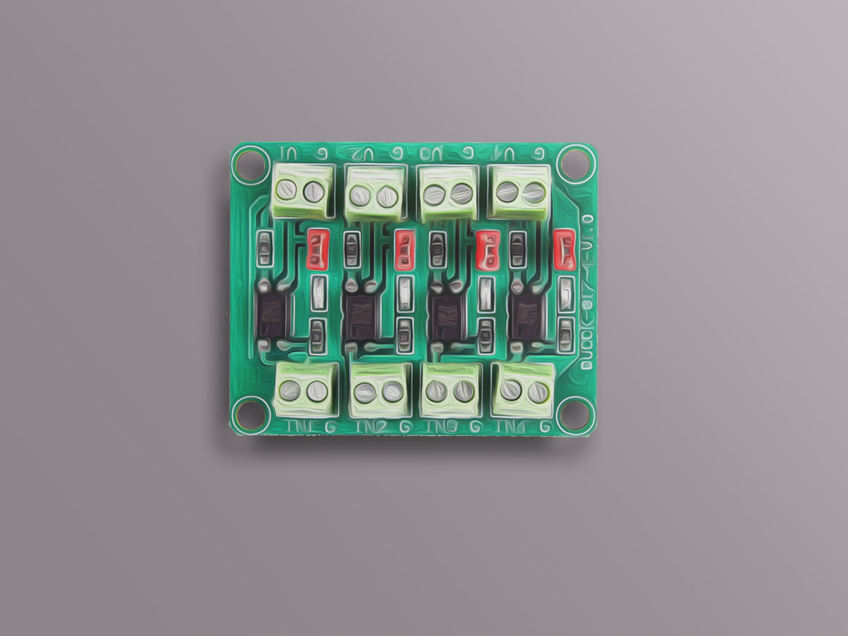

Do I just need to place an octocoupler at the end of each wire coming from the mic logic circuit, then connect the other end into the digital i/o pin? Can I leave the mic's logic ground out then still? I could avoid dupont connectors altogether, if I had an octocoupler with screw terminals (one of those came up when I googled) for in and out. Or maybe there's such a thing as an octocoupler I can just plug into the i/o pin. For this first iteration I've got about 20 mics to do, but after its done, I'll need to replicate this a bunch of times. So, looking for quick ways to put this together, without too much soldering. At an absolute minimum I likely have to solder the logic wires inside the XLR cable as they're so tiny probabyl no other way to join to the. Stripping them sucks too.

This article is interesting and on the right track I think. I see there are 8 input modules too at least. I wonder if there is simiar with enough optocouplers for a mega i/o. Also, I think what would be simplest is if there was something that only required one 5V and Ground connection for the whole optocoupler collection.
I was considering something like this (hopefully cheaper)...
or this...
But I was planning to also use an ethernet shield, but I'd have to switch to using an ethernet module instead.
And with the optocoupler consideration below, I may get the screw terminals with the optocouplers, so this kind of thing might not be needed then.

That PC817 board would do the job, but you certainly don't need that ground link jumper.
That defeats the use of an opto coupler.
I would gain some experience with that PC817 board, before going the next step.
Leo..

The safe way to do this is with an opto coupler.
That will also eliminate the possibility of introducing noise in the audio.

Given that I'm gonna need like 40 optocouplers... That's 10 x PC817.
