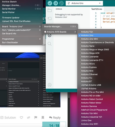

 ![Screen Shot 2024-09-21 at 19.52.23](https://europe1.discourse-cdn.com/arduino/original/4X/f/f/c/ffca21ce4bac75949e5abe5d8244c7f388a2d8ff.png)
here is the port and i am using IDE 2.3.3

Use tools / board to select the board and tools / port to select the port.
Which operating system?

> [@enkheee](#):
> As i showed here i picked the Ardiuno UNO system
Use tools board, not that drop down.

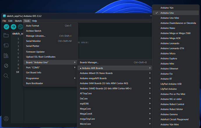

**Author:** ![sterretje](https://dub1.discourse-cdn.com/arduino/user_avatar/forum.arduino.cc/sterretje/32/391294_2.png) [@sterretje](https://forum.arduino.cc/u/sterretje)\
**Post date:** [September 21, 2024, 12:08pm UTC](https://forum.arduino.cc/t/programmer-not-responding-error-pls-help-me/1303676/15 "2024-09-21T12:08:29Z")

![image](https://europe1.discourse-cdn.com/arduino/original/4X/8/9/b/89bf8c666f430acda7daeb6da48f16f2540cb341.png)

Thank you for helping on that and btw it is on Ardiuno UNO
 ![Screen Shot 2024-09-21 at 20.39.09](https://europe1.discourse-cdn.com/arduino/original/4X/5/7/b/57bdf203120ba91d4a77b2dc85c5da78c854e798.jpeg)
<div class="post-metadata">
**Post date:** [September 21, 2024, 12:46pm UTC](https://forum.arduino.cc/t/programmer-not-responding-error-pls-help-me/1303676/20 "2024-09-21T12:46:51Z")
</div>
> [@enkheee](#):
Based on the topic title, you seem to have an upload problem.
You've currently selected _/dev/cu.usbmodem101_. Are there other entries in tools / port?
If yes, try those.
I not, the question is if _/dev/cu.usbmodem101_ is indeed the Uno. To find out
1. Close that menu.
2. Disconnect the Uno.
3. Open the menu.
If _/dev/cu.usbmodem101_ is still there, it's not your Uno.
