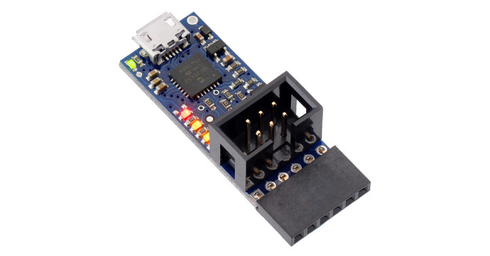

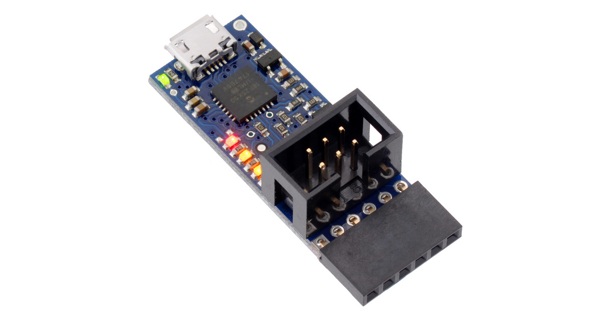

This is by far the best AVR programmer I've ever had the pleasure to use. It works either as an extremely versatile ISP programmer, or serial port interface if you have a bootloader in place.

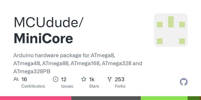

Hi @snolan123. I recommend the use of the excellent 3rd party "MiniCore" boards platform to add support for the ATmega8A to Arduino IDE:
You can install MiniCore via the Arduino IDE Boards Manager:
https://github.com/MCUdude/MiniCore#boards-manager-installation
After installing MiniCore, you can configure Arduino IDE for use with an ATmega8A running on the internal oscillator by the following procedure:
  1. Select Tools > Board > MiniCore > ATmega8 from the Arduino IDE menus.
  2. Select the appropriate clock configuration from Arduino IDE's Tools > Clock menu.
  3. Configure the other submenus of Arduino IDE's "Tools" menu as needed.
As @van_der_decken mentioned, the factory default configuration of the board is running at 1 MHz. You can increase this to 8 MHz if you like. You would do that by the following procedure:
  1. Connect an ISP programmer to the ATmega8.
    You can use your UNO board as a DIY "Arduino as ISP" programmer: https://docs.arduino.cc/built-in-examples/arduino-isp/ArduinoISP/
  2. Select Tools > Clock > Internal 8 MHz from the Arduino IDE menus.
  3. Select the appropriate programmer from Arduino IDE's Tools > Programmer menu.
    If you are using the "Arduino as ISP" programmer, select Tools > Programmer > Arduino as ISP
  4. Select Tools > Burn Bootloader.
In addition to flashing the bootloader binary (which is optional when using MiniCore), the "Burn Bootloader" operation also sets the target microcontroller's configuration fuses according to the configuration from the board definition. So this is why you must perform a "Burn Bootloader" operation after changing the "Clock" configuration:
https://github.com/MCUdude/MiniCore#supported-clock-frequencies
