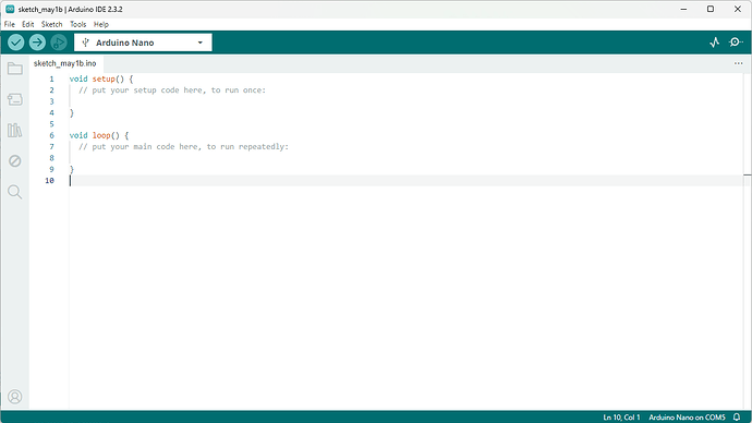

In the IDE, use file / new. You will see something like this
Compile it; does it compile?
Next, at the top, create a few empty lines. Replace one of the empty lines with #include <FastLED.h> so it looks like
Compile it; does it compile? If not, post the complete error message; in IDE 1.x you will see a button "copy error messages" in the orange bar, in IDE 2.x there will be a popup at the right button and you can click "copy error" (or something in that line, I don't have access to IDE 2.x at the moment). In both you can also select all text from the output window, copy it and paste it here.

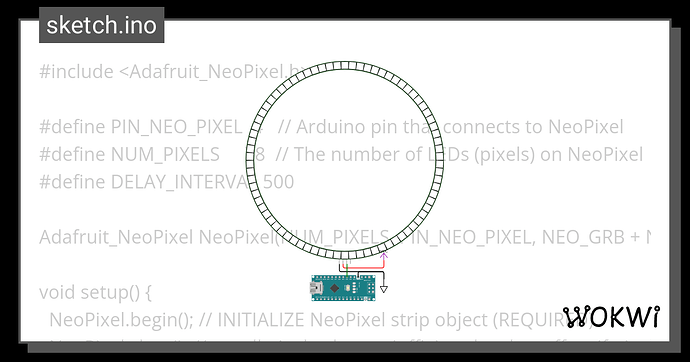

this is my code
    #ifdef __AVR__
    #include <avr/power.h> // Required for 16 MHz Adafruit Trinket
    #endif
    #define PIN_NEO_PIXEL  4   // Arduino pin that connects to NeoPixel
    #define NUM_PIXELS     30  // The number of LEDs (pixels) on NeoPixel
    #define DELAY_INTERVAL (500)
    Adafruit_NeoPixel NeoPixel(NUM_PIXELS, PIN_NEO_PIXEL, NEO_GRB + NEO_KHZ800);
      NeoPixel.begin(); // INITIALIZE NeoPixel strip object (REQUIRED)
      NeoPixel.clear(); // set all pixel colors to 'off'. It only takes effect if pixels.show() is called
      // turn pixels to white one by one with delay between each pixel
      for (int pixel = 0; pixel < NUM_PIXELS; pixel++) { // for each pixel
        NeoPixel.setPixelColor(pixel, NeoPixel.Color(255, 255, 255)); // it only takes effect if pixels.show() is called
        NeoPixel.show();   // send the updated pixel colors to the NeoPixel hardware.
        delay(DELAY_INTERVAL); // pause between each pixel
just looking to turn on each pixel one at a time in white and all stay on when finished.
until the circuit is turned off (in this case by cutting power)
Works perfectly.
Files for WOKWI.COM
sketch.ino
#define NUM_PIXELS     78  // The number of LEDs (pixels) on NeoPixel
#define DELAY_INTERVAL 500
  NeoPixel.show();
  while (1); // remain here forever
diagram.json
  "version": 1,
  "author": "Anonymous maker",
  "editor": "wokwi",
  "parts": [
    { "type": "wokwi-arduino-nano", "id": "nano", "top": 0, "left": 0, "attrs": {} },
      "type": "wokwi-led-ring",
      "id": "ring2",
      "top": -554.75,
      "left": -166.1,
      "attrs": { "pixels": "78" }
    { "type": "wokwi-vcc", "id": "vcc1", "top": -66.44, "left": 182.4, "attrs": {} },
    { "type": "wokwi-gnd", "id": "gnd1", "top": 9.6, "left": 181.8, "attrs": {} }
  "connections": [
    [ "gnd1:GND", "nano:GND.2", "black", [ "v-19.2", "h-67.2" ] ],
    [ "gnd1:GND", "ring2:GND", "black", [ "v-19.2", "h-105.6" ] ],
    [ "vcc1:VCC", "ring2:VCC", "red", [ "v19.2", "h-96" ] ],
    [ "nano:4", "ring2:DIN", "green", [ "v0" ] ]
  "dependencies": {}
Be aware that you can not power all 30 LEDs on full white at the same time from the Arduino 5V pin; around 5 at the same time is more than likely the maximum. After that, you will need an external power supply; below a wiring diagram (I think by LarryD)
