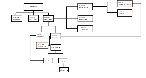

hy,
Thanks for the response.
Something like that graphical programming but more simple with a bigger view. I don't like the structure.
I added a small sample in the link below on how it should look. Something like this I am looking for.
So you only need to deal with logic and knowing your setup of course.
For special components or parts on the setup you would also be able to assign libraries or drivers inside those blocks etc etc...

Have you written any code?
Even with the example in post #1 has some structure and an order of doing things,
Your posted example shows no logical flow.
You MUST load the servo library first, then setup input and output ports, then iinitialize the servo, then read a button, then drive the servo.
I am not sure what your posted example is supposed to do.

ChrisTenone:
Writing a flow chart compiler would be a real fun project tho ...
The thing in the OP's diagram is not a flow chart. It is just a list of components and libraries without any indication of what anything is supposed to do. :slight_smile:
...R
Robin2:
...R
Right!
A flow chart is unambiguous. Here is an old school flow chart for reading an RTC and displaying the time:
@OP, notice how each instruction is sequenced, and every line has a direction?

Good. That is a neat framework which shows how all the components of your final program are going to fit together. But you can't just load that into the Arduino and expect it to know all the other stuff that is in your brain.
The top-right has a box for "servo initial position". What is the position? You have to give the compiler an actual number. This box needs a space to write the number.
Under that you have "servo limits". Once again you need numbers. You also need to tell it what to do: should it just stop or flash a light or sound a buzzer?
When you put a complete programming language into graphical form like this, each box ends up quite large with lots of details inside it. The diagram no longer fits on one page. So you cannot look at the whole diagram and understand the whole program.
The other problem with graphical languages is they can only do what the designer thought of. It is difficult to add new abilities. If the language doesn't include a box for something like an IMU sensor then you can't add it. When the original Arduino designers created the system in the 2000's, they did not know that thousands of those sensors would become available very cheaply.
The wonderful thing about Arduino is that it can be used to make a gigantic number of projects that the original designers could not have thought of.
hy,
Guys it was just a question to get a rough idea how this could work out.
The diagram I made it in 5 minutes I didn't even intend to use something like this and I'm sure it's far from perfect. This was pure for setting an example of what I had in mind.
The purpose of this question was to find out if there is anything already like this out there for me to use in order to write codes more easily for Arduino.
Doing something like this myself sounds like fun but I don't have the knowledge yet.
Also, this seems more logical to learn how to write programs if one would start from this approach instead of the code directly and all those prefixes etc etc .. One could than break this blocks/chunks of code and go deeper inside it to see the code itself if one must. In my opinion this would make people learn much faster how to write programs.
