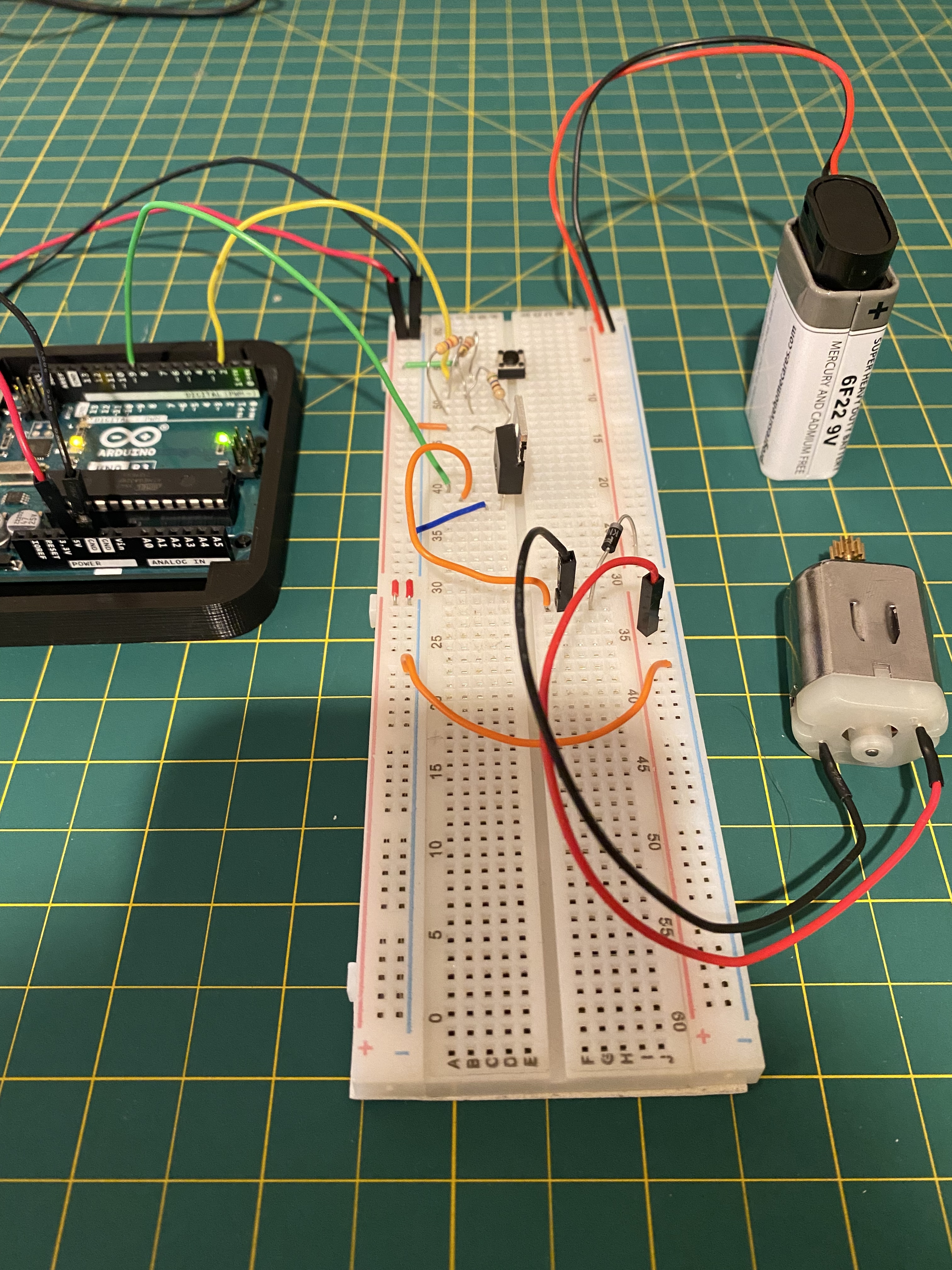

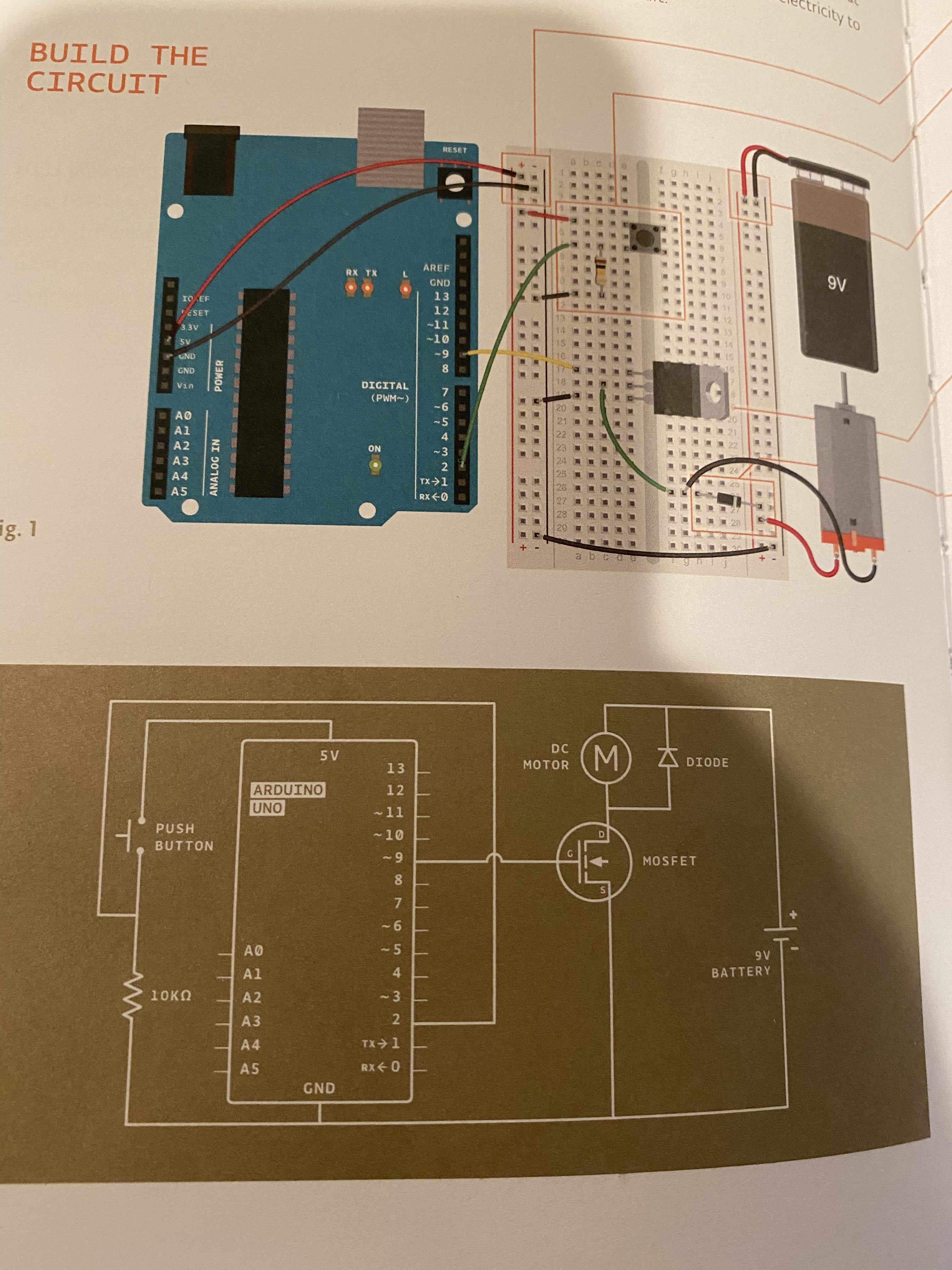

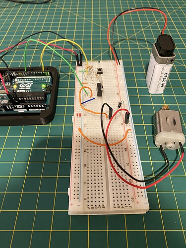

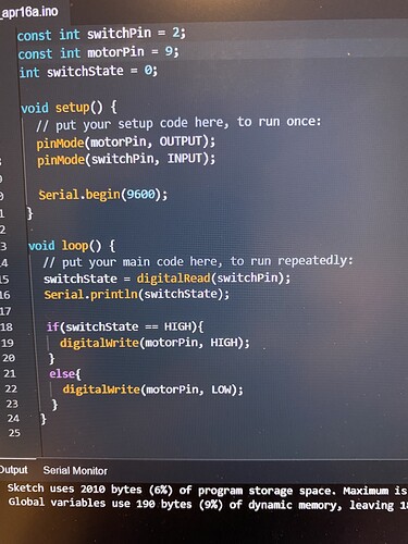

I am going through the starter kit and I am currently on project 9. I seem to have followed every step correctly and yet the motor will not spin. I just added a couple lines to the code to get a serial output to check to see if the button was working, and it is. I also checked the 9V battery I have with a multimeter and it’s also good. The attached images are showing what I have and what the book shows. Any help is appreciated.
On the Arduino side of the board you bridged the two power rails over gap 30, repeat that on the motor side of the board.
Ah yeah, you're right. I feel so dumb now, idk why I thought to do it on that side but forgot the other side. Thanks!
