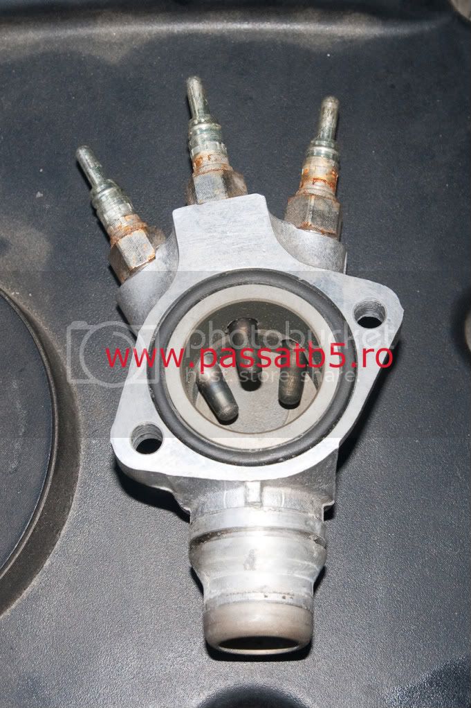

this systems are in the VW passat 200-2005 diesel engines end controled by the car ECU. The glow plugs are drifrent from the ones that start the engine but same principle. The stay in a houseing in back of the engine and in the cold winter it helps the engine heat up faster. And i whant to put one of this system on a mitsubishi pajaro.
this is from the passat

The components are "heaters" not "glow plugs",they will not glow while immersed in water. Please use the correct terminology.
