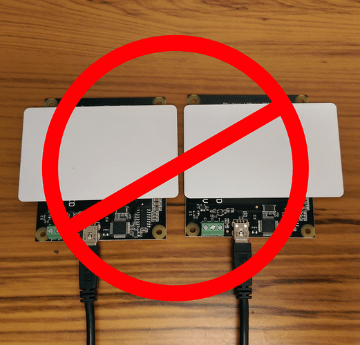

It helped me, but did not address my key concern, that is the challenge (I assumed) of having multiple readers within a small area.
I found this
