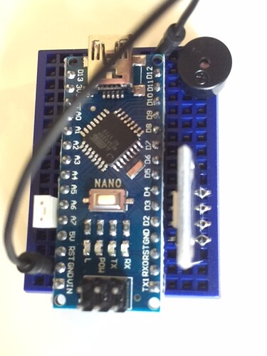

I've uploaded code for it and it does power up via usb connection, makes a sound and i can change the frequency range. My question is i'm pretty sure humans aren't supposed to hear in the 40khz range and i can hear this annoying noise from it which gives me a headache so, i'm wondering how do you know if you have the right buzzer? I only want to cover like a 5-10ft radius of ultrasonic sound. second part is i'd like to put this on an ethernet cable between a switch and another device and just draw enough power to power this via a few watts of poe, not sure how to accomplish this.

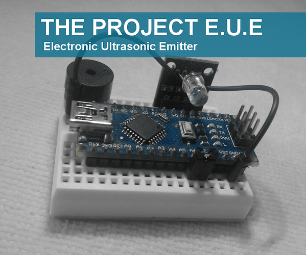

attached a pic of my project and thank you for any input.

Are you sure is't a passive buzzer.
Passive buzzers usually don't have a + sign on top. Your one does.
Try the buzzer on the 5volt pin.
Leo..

well i believe so :slight_smile: also not sure how to plug the buzzer into the 5v as next to it is a jumper.
think i should have bought a buzzer with wires vs. pins for more flexibility.

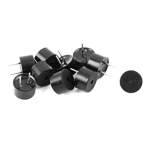

buzzer i got was this one

Looked up the Amazon site and see this: 2 Terminals,complete drive circuit incorporated for direct operation from AC power source.
Even though the text says AC, the + on the case means it is is an active piezo with a single frequency output.
