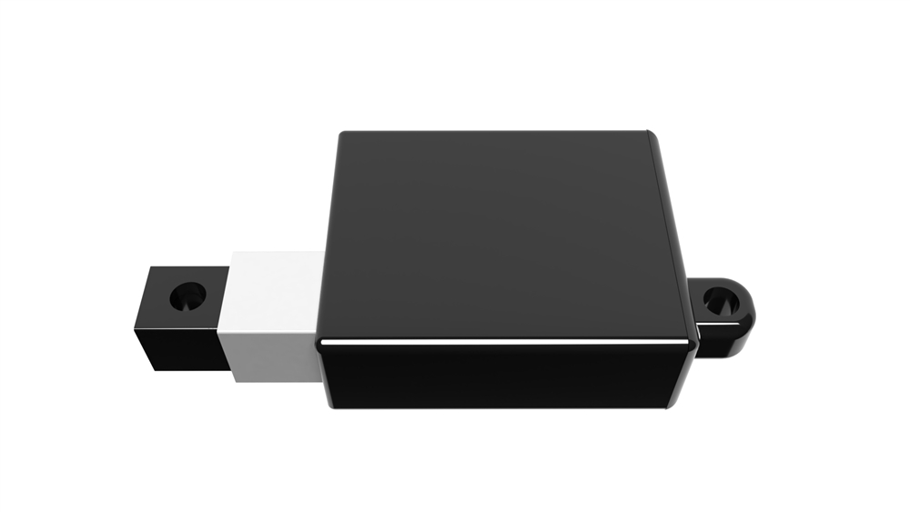

  3. Stepper motors are small linear steppers that are 0-4.2v motors with .256 amps per phase and 15 ohm resistance.

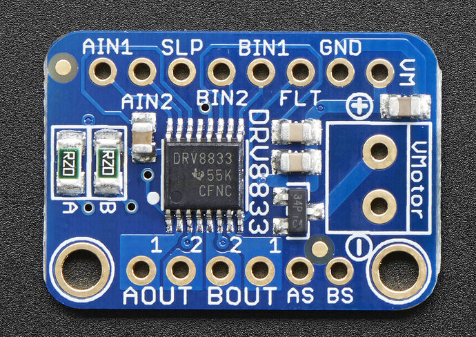

So I was looking at that CNC board. I have DRV8833 chips...
This is the stepper motors I"m using...

But I do have 4 of these DRV8833's, which could be used on a CNC board perhaps.

More importantly is the max current (per phase) setting of 256mA... that is so it doesn't get toasted... correct? I looked at stepper drivers like the A4988 but they only go down to 600mA minimum. I think this is why another user suggested maybe the DRV8833 drivers because I could break the Rsensors on it and put my own resistor in place to get it down to a safe smaller mA.
I would need to get a CNC board of course to put these on if I use the DRV8833's... sounds like the way I need to go.
