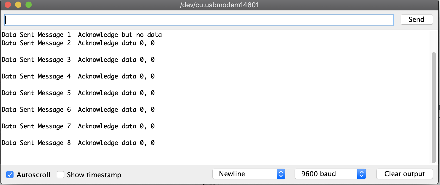

Finally got to try your examples. The 1st one worked, the 2nd one too I think...'Acknowledge but no data" does comes up in the serial monitor, so SOMETHING is happening which is better than before when it kept going "Data Sent Message 0 Tx failed".

For the 2nd Example, this is what the serial monitor looks like for the transmitter:

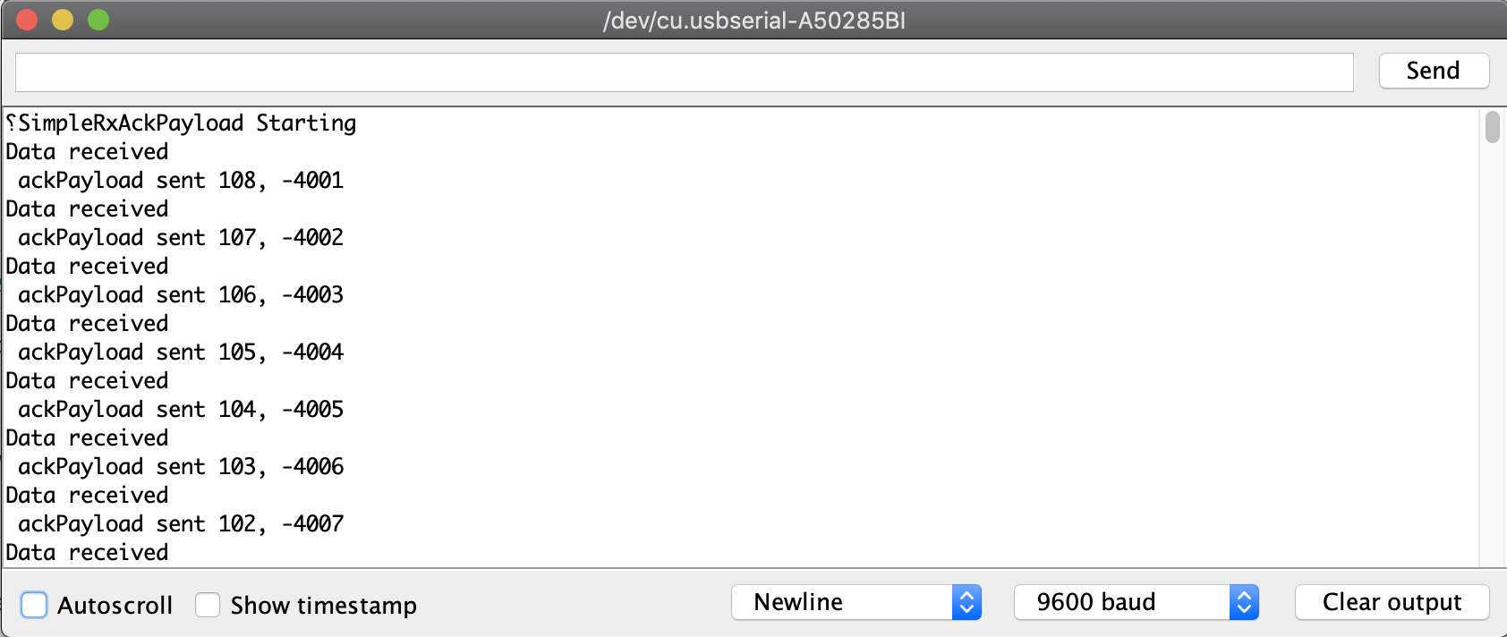

And this is what it looks like for the receiver:
Also I'm using a different nrf24l01 module than yours. Here's the connections I used:
Does this mean your example is working fine for me?

Please post the two programs that YOU have uploaded to your two Arduinos.
For the future, please don't post pictures of the text output - just copy and paste the text.
It seems that your nRF24 modules have the same nRF24 chip as mine so I would expect them to work the same.
