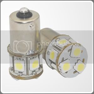

we might need these.

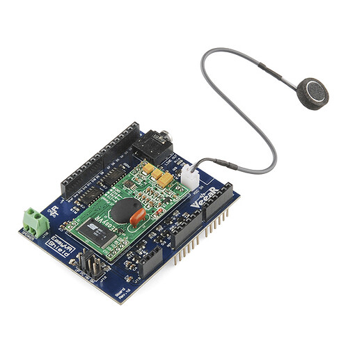

EasyVR Shield - Voice Recognition Shield EasyVR 3 Plus Shield for Arduino - COM-15453 - SparkFun Electronics

i want to turn on and off any light in camper by saying "Arduino, turn on light #".
