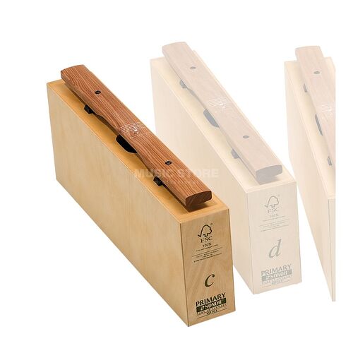

Wow, so much response, thanks a lo, great community! I am on my phone, cant write that much for now, but to make it clear, i want to build a large xylophone and play it with an arduino.... I dont want to hit the wood, I want to make the wood vibrate without touching it. I want to place a permanent magnet inside the wood... Below the wood should be the electro magnet. The 50-200hz range was just an idea... I like dark, deep drones... And since I want to make large wood elements... the will be more on the bass side...

If those are your vibrational frequencies, think more about planks. A resonanant chamber to make something like that audible, would also be huge. Think about when the last time you saw a bass xylophone was.

A xylophone works on resonance. Each brick has its own note, which it plays after a stroke. Then a periodic excitation is not required. It's near impossible to make it produce a sound of a different frequency, unless the bricks are almost as thin and light like a loudspeaker membrane.
Try to play a single brick in the intended way, to find out yourself about the limits of your plan. If you can make it work, it should be not so hard to extend the instrument to play multiple or other tones at the same time.

For testing I will build something like that:
Inside the wood, in the middle and above the electro magnet (with a gab of 1mm) I will place a strong permanent magnet.
So, driving/switching a electro magnet with a motorshield can work?
How are you going to tune the blocks to the correct frequencies?
You can tune wood blocks easily by cutting and sanding in the middle or outside their nodes (places where they dont vibrate).
I expect you will have quite a learning experience with all this.
As I understand (poorly at best) creating a resonance nearby a thing that has the same resonance frequency, you can get the thing to vibrate at the same frequency. magnets have a very short distance for their magnetic field.
as you apply power, the thing you want to vibrate, will start to vibrate and eventually vibrate at the same power as you apply from your remote thing.
the location of the magnet will be important as it will need to be placed in the section that vibrates. the further away, the more power it will take, and most likely, the longer time period before the resonance has an amplitude that creates an audible noise.
contrast to a striker that would replicate the way the device is operated manually, with instantaneous sound.
Please keep us posted, you have a fascinating project.
