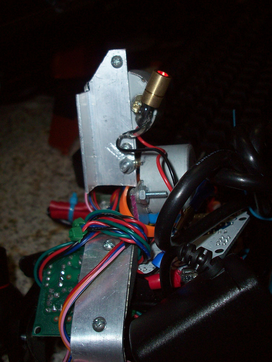

Hello.
Could you show more photos of your stepper mounts with each other ?
I try to make similar device but wonder how to mount this steppers to kind of pan-tilt system.
Also very interesting how to solve problem with limits rotation shaft ?
I need to rotate shaft from 0 to 180 or may be more but if it not going round and tear my cables.
What kind of limit do you use ?

For some reason I didn't get the email notification of a thread reply, sorry!
I'm at work but I will take some pictures of how I secured them when I get home.
Thank you ! I'll wait for pics.
d00m:
So sorry for the delay!
Here you go:
I drilled a hole in the motor spindle and then used a small nut and bolt to secure it to a piece of aluminum angle bracket. Once you have the aluminum secured to it, you can mount pretty much anything... like another motor!
For the laser I just used epoxy.
Thank you !
Looks like you didn't care about limits rotation shaft ?
How you solve the problem that cable from laser and from second motor (one that with laser) can be going round and torn ?
Did you use some limits in your program code ?
d00m:
Thank you !
There are no limits in the arduino code, though there should be and it wouldn't be hard to add them. The limits are in the coordinates passed from python to the arduino, if everything is calibrated correctly, the laser should never rotate more than 70 degrees in any direction
If you are needing something that can rotate infinitely, you might want to look into a slip ring like this: Slip Ring with Flange - 22mm diameter, 6 wires, max 240V @ 2A : ID 736 : Adafruit Industries, Unique & fun DIY electronics and kits
