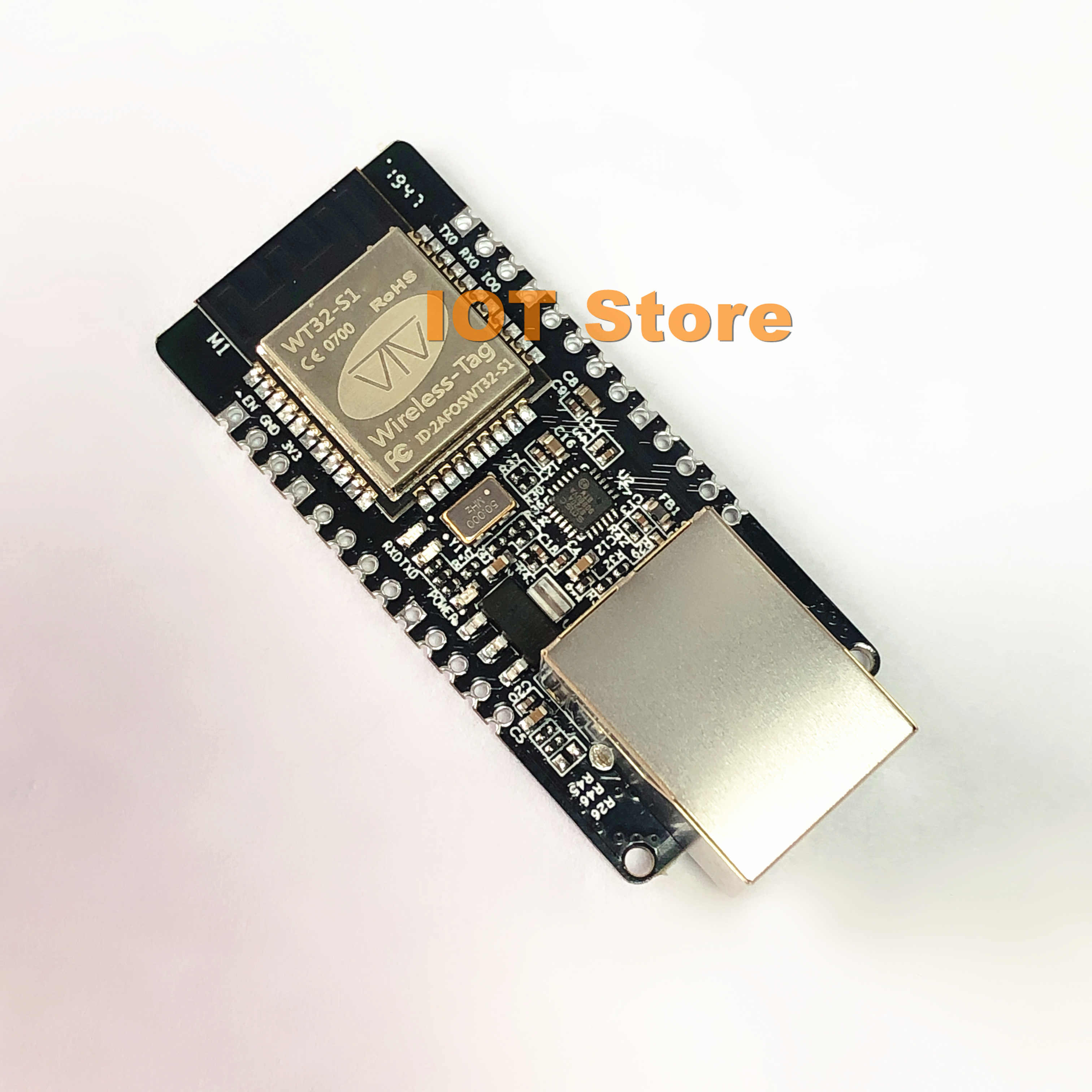

What about an esp32 with Ethernet, like this?
