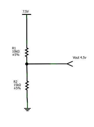

My sensor outputs 7.5v 100/150mA when its high.
Currently I tie this line to ground with a 10k resistor, and regulate it to 3.3v with a TS2950CT-3.3, before connecting to a digital pin on the arduino. Is this a correct way of doing things? Do I need to add or change anything?

No. Do not use a voltage regulator for signal level shifting.

The simplest way to do this is to drive the output of your sensor through a potential divider to cut down the maximum voltage to about 4.5V to feed into the digital input pin of an arduino.

Because it is not designed to do such a thing. It will not be stable and will not respond fast.
It is like saying hey I want to use a food blender to chop up my Christmas tree for the compost.

So in theory a voltage divider using r1 = 15k, r2 = 12k, will give me the same output of 3.33v. What is the advantage of taking it higher to 4.5v? I always thought Id keep things lower to offer more protection.
Are we talking about an arduino that runs on 5V, you haven't said.
Basically you want the signal as close to the supply as possible and in any case not more than 0.5V above it.
While a 5V arduino will respond to a 3V3 signal as a logic high it is more susceptible to noise and interference.
Sorry yes Arduino Uno.
The sensor actually outputs 0.3v when it is LOW, do I need to account for this in any way?
So changing r1 to 10k, r2 to 15k now gives me ~4.5v, when the sensor is HIGH.
The 0.3V will be divided down to something like 0.2V, well within spec for a logic LOW :slight_smile:

For instance for the ATmega running at 5V supply, VOL = 0.9V and VIL = 1.5V. This means upto 0.6V of noise can be injected onto the signal line between the devices and a LOW will still always be recognised correctly. In digital circuits there is always noise being injected via stray inductance and capacitance, so this "noise immunity" can be very important.
On the high side VOH = 4.2V and VIH = 3.0V. Thus you want your resistive divider to output between 4.2V and 5.0V for a HIGH and between 0.0 and 0.9V for a LOW.
At a pinch you will get away with the ranges 3.0V..5.0V and 0.0V..1.5V, but this means you lose "noise immunity" - there is a risk of noise interfering with the correct recognition of the logic signal. 4.5V for HIGH and 0.2V for LOW are fine of course.
