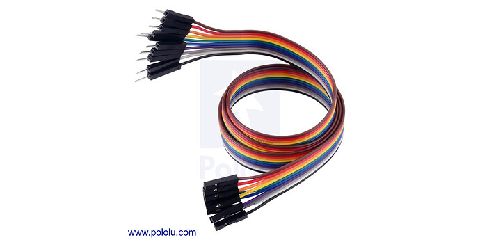

I agree with Nick that it's better to use headers, rather than solder directly to the board. However, I would use 0.1" male headers and not the Arduino style female headers, as the male headers are more industry standard, and you can make more permanent connections, eg check out the jumpers with "female" headers here, http://www.pololu.com/catalog/category/65
