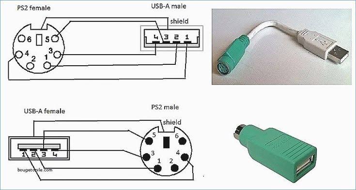

What If I want to replace a PS2 pin with a USB Jack ???
or say
If I want to use PS2 just like a USB atmosphere, is it possible to connect data and power lines directly to the relevant USB pins or need to have a convertor type thing ???
Got a picture related to this matter
Is this type of direct connectivity is good enough or need to add something ??
