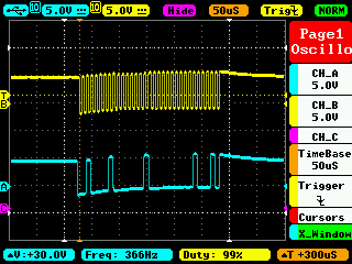

Ok, so I'm making some progress, and got my hands on a pocket scope. Here's the signal generated from the above:
The first mistake I realised is that, even after setting SPI MODE 2, that doesn't mean the clock idles HIGH. So I manually added a digitalWrite(13, HIGH) to pull it high before and after the SPI transaction. That made things look better, but still no response.
