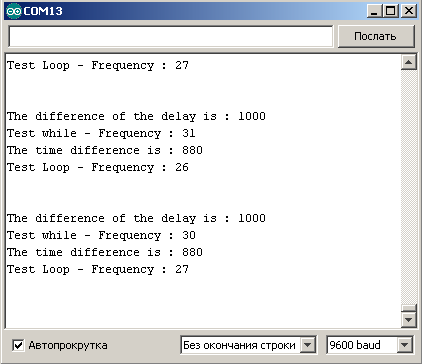

Hi guys
I have made the impeller sensor for my weather station (wind speed sensor). It gives pulses of 700 mV; one pulse per rotation. Where can I stick the output pin of my sensor in order to make Arduino Nano (328) feel it well? As I understood 328's DS - to AIN0 or AIN1 pin of 328. But I don't know which way I have to modify this scetch to run my system properly:

Anemometer's impeller sensor (made out from 25 mm PC video card' cooler) will be embedded into handheld gadget like 'Kestrel 4500' pocket wheather station. So distance between sensor's IR and Arduino is just out of my issue.
Unlike power effectivity, which is one of the main points of the project. The distance between IR emitter and receiver is about a couple of mm, so I've been permissed to reduce the IR emitter's current dooooown to 200 uA. Quite the same current is appointed for IR receiver (phototransistor). So total consuption of my IR-interruptor now is around of 350 .. 400 uA, which enjoy me very much.
Did the 'manufacturer' give you comprehensive answer to your request? ))
This morning I just plucked up with my heart and connected the output wire of my impeller's IR sensor to D2 pin of Arduino Nano '328. Before this I had changed the IR-emitter' resistor so consumption current has rised from 200 uA up to nominal 20 mA, so the output signal's amplitude has rised from 700 mV up to a bit less than 5V. This signal's level allowed me to engage the logical pin instead of analog comparator (it was made in order to simplify the first steps).

Well, the difference between 'test 'while' and 'test 'for' is like 30 and 27 respectively, in average, i.e. about 3 .. 5 pps (Hz), as represented on screenshot below. What does it mean and what should I do next? Which result is true (or just more accurate)?
