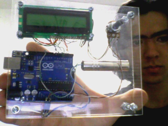

I'm making a pulse reader with Arduino, Atmega 328, Linux, and Photogate.
doing: digitalRead(pin); I get 0 when interrupt photogate, 1 when I don't. %%%% Fotogate works well, without interruptions %%%%%
doing: pulseIn(); I just can read pulses shorter than 2 s more or less (200000 micros).
Any idea?

Which version of the IDE are you using ? 1.0 or 0.22 ?
How did you connect the photogate ? Please post schematics?
arduino 0022+dfsg-4ubuntu0.1, the scheme is just pin of data (gate) to pin 7.
here's a pic
I'd read some on http://arduino.cc/forum/index.php/topic,74813.0.html, and here: Google Code Archive - Long-term storage for Google Code Project Hosting., but I don't know were find pulseIn to repairit. the code shared by Nick Gammon in the first url presents a half solution but have some crazy problems too.
Wherever your Arduino installation lives, look in ../hardware/arduino/core/arduino/wiring_pulse.c
