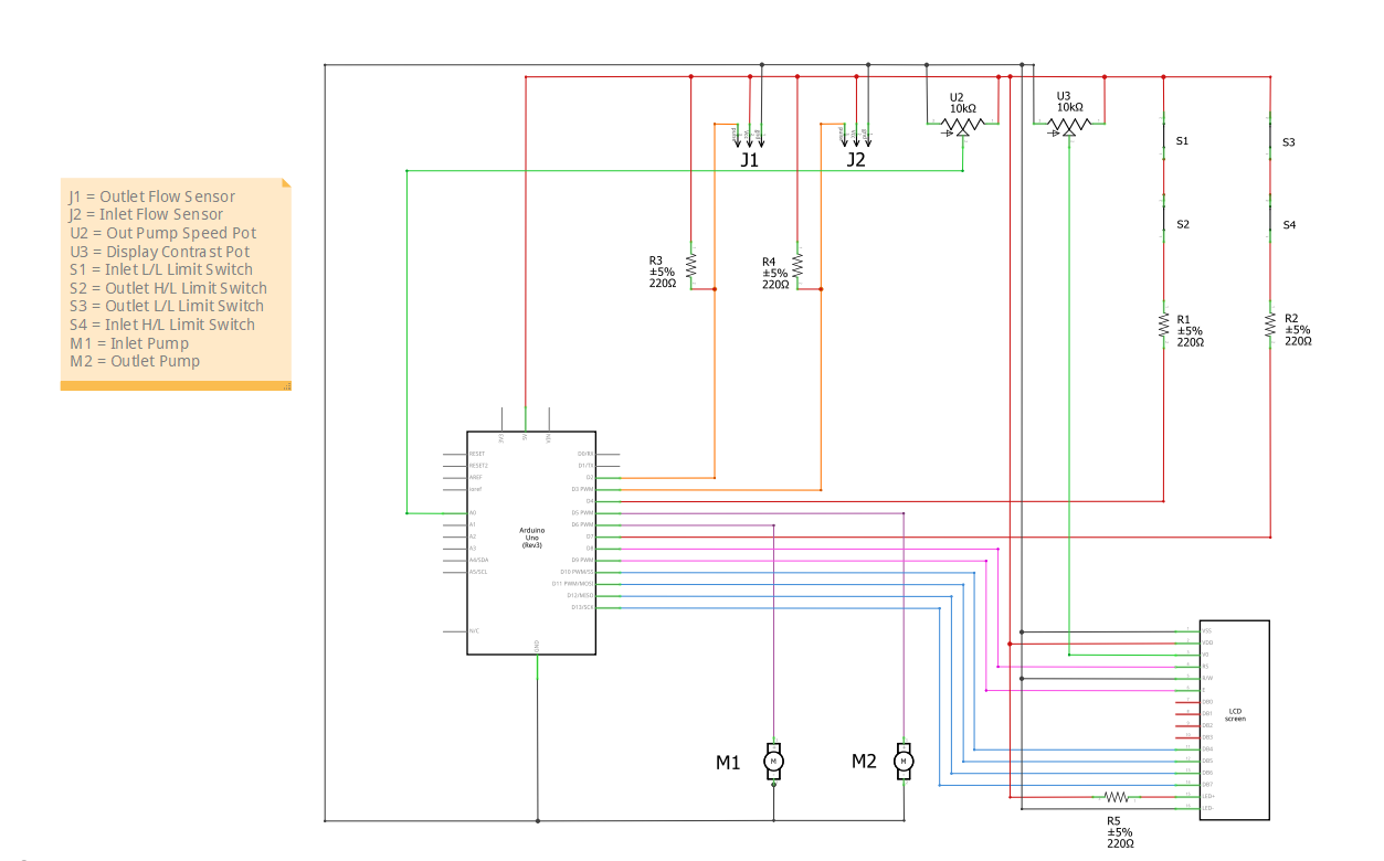

Hi folks.
I hope I get the format correct, 1st time using the forum and I'm following the guide as best as possible.
I've a college project where I'm trying to control the speed of an inlet pump by the flow rate of the outlet pump. Outlet pump is controlled with a pot. each 24v pump is controlled via Mosfet PWM drivers capable of 30v. Outlet pump is 750L/hr and inlet pump is 1100L/hr. Flow meters are 0 - 60L/min calibration factor 7.8, pulse per litre 468. The issue I have is the inlet pump speed won't vary regardless of what speed the outlet pump is running at. In the code you'll notice some of the mapping figures are different than expected, I've been changing things looking for answers.
Thanks in advance,
Jay

Always show us a good schematic of your proposed circuit.
Show us good images of your ‘actual’ wiring.
Give links to components.
  • Avoid using delay( ) as it blocks code execution.
If the switches are wired in series, why do you have 2 inputs?
Post a wiring diagram.

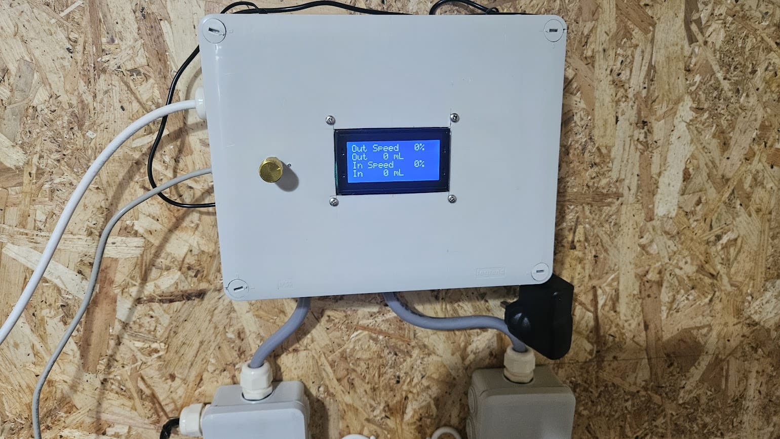

Please tell us you can VARY the speed of the input pump. So the problem is only computing the correct speed value.
yes, I can vary the speed of the outlet pump with the potentiometer
A set for each of the 2 pumps
If either of the limit switches are open how would it be true?
And yes I do need to learn more about C++ but I've never done any coding until January, its a college project and time to learn is my enemy. With all due respect I wouldn't be on here if I had the answers.
I was running it without the delay but the flow rate display on the LCD was unreadable because it was changing constantly
  • Inputs D4 and D7 are not wired properly.
  • Update the schematic showing how the motors are actually wired.
    As you show, a GPIO cannot be connected to a motor.
If the flow rate is constantly changing, either your calculation of the rate is flawed or there is something wrong with your circuitry. Is the flow rate constant with no flow?
Two pumps in series will never work unless the first supplies vastly more than the requirement of the second.
If insufficient, all you will end up with is cavitation on the second.
This can be avoided by the use of a sufficiently sized "ballast tank".
Fluid dynamics is a wonderfully complex subject made more so because fluid has density and is hard to get moving and equally hard to stop moving.
Hi Larry,
Sorry, the schematic doesn't show the PWM controlled relays, I used Fritzing and its limited with available components. Pins 5 and 6 are connected to the PWM terminal of each of the 2 relays, pumps are wired through the load side from a 24v power supply. I have the 2 pumps running now, outlet pump speed controlled by the pot and the inlet pump speed varies according to the outlet speed.
