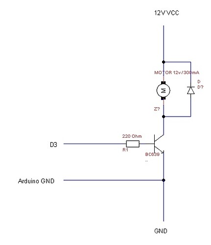

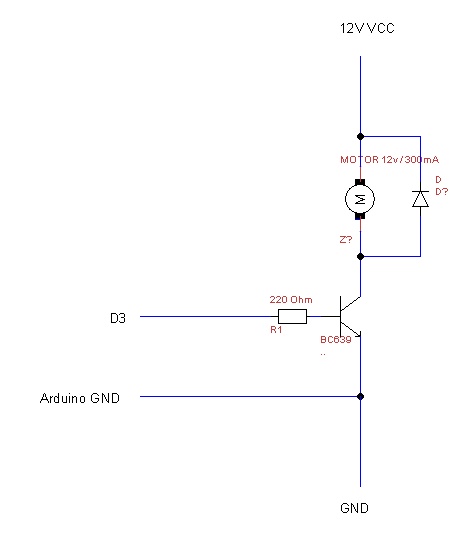

Thanks for all your replies.
My circuit looks like this (see attachment).
Before, I connected the transistor between VCC and the fan.
Now with the transitor beween GND and fan is much faster ( just goes up to 200mA) and also switches off completly with analogWrite(3,0);
Can I go even lower with the base resistor to get closer to the 300mA or do I risk to blow up the Arduino pin?
Thanks!
Don't lower the base resistor.
There will always be a voltage drop across a transistor. Should be <= 0.5volt with a BC639.
You can compensate for that by using a slightly higher supply voltage (12.5volt).
Not that it will make much difference to actual air flow.
Did you measure that 300mA with the fan not spinning (blocked), because that is what the 300mA probably means.
200mA is already higher than I expected.
Leo..
Use 150 ohm base resistor, its about the minimum its safe to use.
Thank you for your help! :slight_smile:
It sounds like it is now being driven properly. To validate this connect the fan directly to the power supply and measure the current, Check to see if it spins about the same speed with either configuration. If not try a logic level avalanche rated MOSFET with the source connected to ground the gate connected to the Arduino port pin and the drain connected to the fan -, connect the fan + to the 12V. No diode is needed as it is part and parcel of the MOSFET. That should work just fine.
