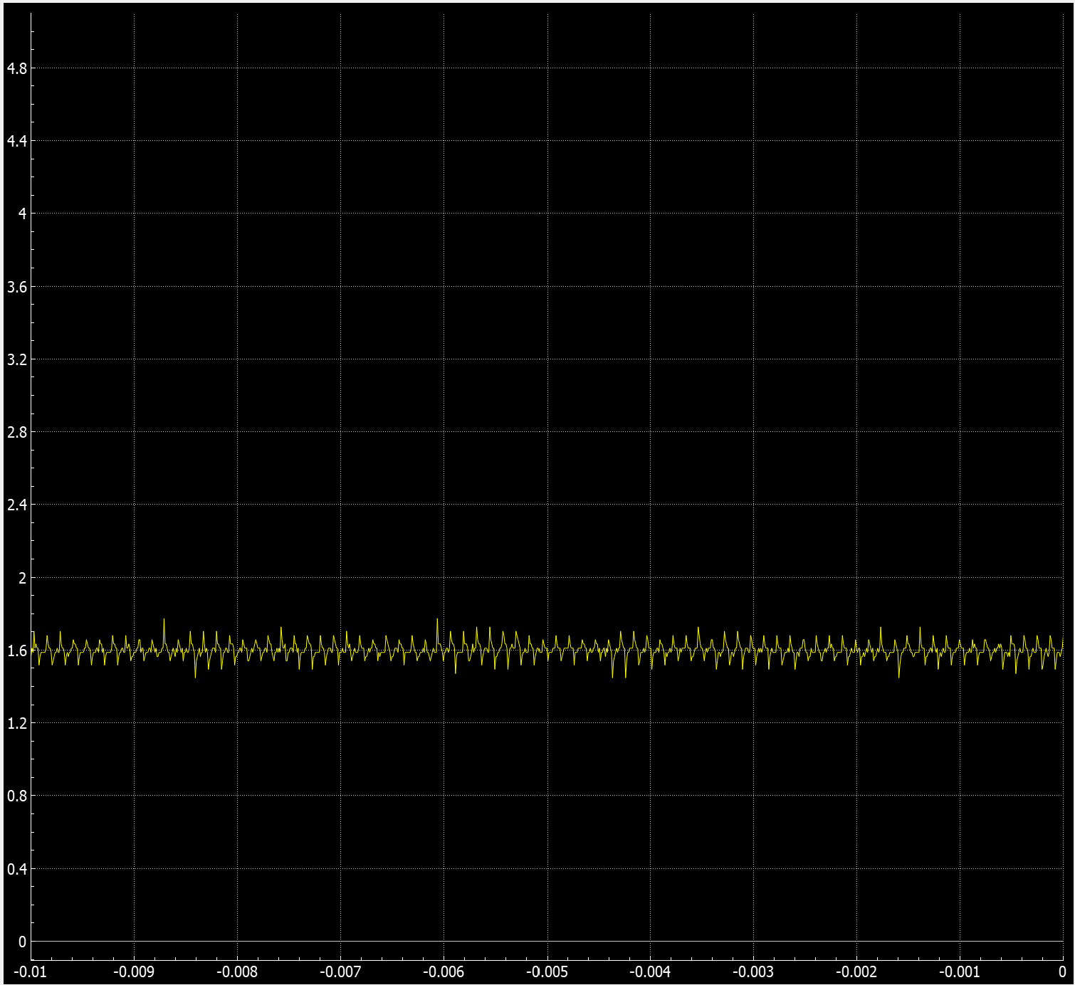

Hi all, I have a project where I am using timers 1 and 2 of an ATTiny841. I am wanting to configure all of them to be 10-bit, fast PWM with no prescaler. I am using Dr. Azzy's ATTiny Core, running the chip at 8 MHz. I have read out the fuses to verify. I have also spent a ton of time in the data sheet trying to figure out what is going on. My code is posted below, but first, the issues I see. TOCC3 and TOCC4 are showing the same pulse train of 28.5 us on, 95 us off, roughly a 20% duty cycle. TOCC2 shows a pulse train of 79 ms on, 79 ms off. TOCC1 shows a static +5V (100% duty cycle). This really has me scratching my head, but it must be something stupid that I just must have glossed over in the data sheet or something. Any help would be greatly appreciated. Also, I have been trying some different ways of representing the data, so you will see binary, bit-shifting, etc. in the code. I know it's inconsistent, but the compiler doesn't mind right now. I'll fix it when I get this actually working. Thanks in advance!
