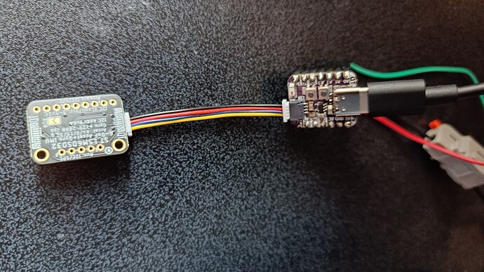

My problem is with trying to get my ESP32-S2 communicating with the LSM6DSO32 for the bouncing effect. I don't know if I've done something wrong but the LSM6DSO32 is connected to the Qt PY using a STEMMA QT cable. My project is to use the LSM6DSO32 to control some LEDs. The photo below shows the connection: -
The LSM6DSO32 appears to be getting power as the green LED lights. Everything appears to be connected as per Step 6 in the instructions.
Here is the code which I compiled and uploaded using the Arduino IDE and it seems to upload without any issues and putting debug "Serial" statements in the code it appears to have uploaded and be running. The libraries appear to be included in Arduino IDE as well:-

The problem appears to be that it never seems to progress beyond the initial WHILE loop which to me would seem to indicate that it is not detecting the board.
if (!dso32.begin_I2C()) {
    while (1) {
      delay(10);
I did try a separate cable connecting the board and also with removing the LED strips from the QT Py to check for a bad cable or a possible power issue. My thoughts are that there is something missing with the code to establish that this should be communicating through the STEMMA cable but that doesn't appear in the original code that is apparently using the same connection as I am.
Any help would be greatly appreciated. Also, if there is something I'm missing please give me some pointers/explanation if possible to help for the future.
If I've not provided enough information or have any questions on what I've done please let me know.
Thanks!
