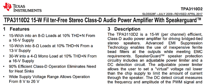

You find wimpy amplifiers because in most cases they use small speakers and everything is powered by only 5 volts. I don't see why you can't use some of the specialized boards like DFPlayer Mini MP3 Player by connecting it to a more powerful amplifier from TPA series for example. For the amplifier you will also need a power supply.
