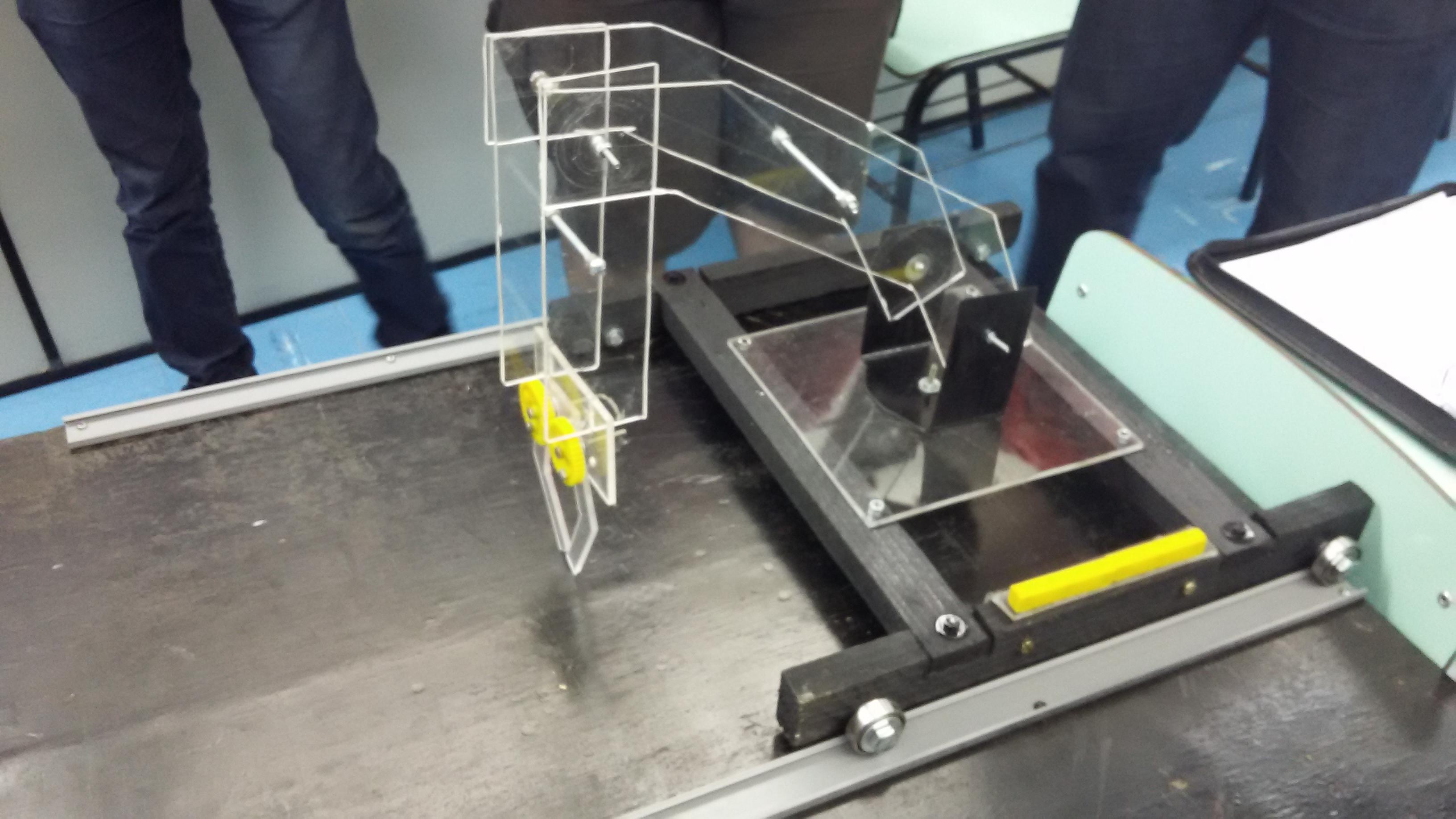

Im going to send you guys a picture of my project. Im using acrylic for the joints and claw and for the base, i used wood.
Like i said guys, when i was testing one servo raising up one joint it was perfect. when i put all the joints and servos together, they dont have enough power to raise up and stays vibrating.

im sending you the photos with the final structure of the project. And no, dont have any bearings its directly on the arm. Only have bearings on the base to move left and right.
Well...if its not obvious, i dont have the servos attached on these photos, just sent to understand better the final structure of the arm.
Using invisible servos, I see. Or, don't see.

Without even seeing what the servos are doing? No. If one servo by itself works properly, but activating more than one servo causes the one that was working perfectly to misbehave, then the power supply is not adequate.
ThatS what I though. I will try to reduce the weight of the arm by Makin some holes on the structure. And try to feed each servo with independently power supplies.
Can you please post a 'photo with the servos attached to the arm.
