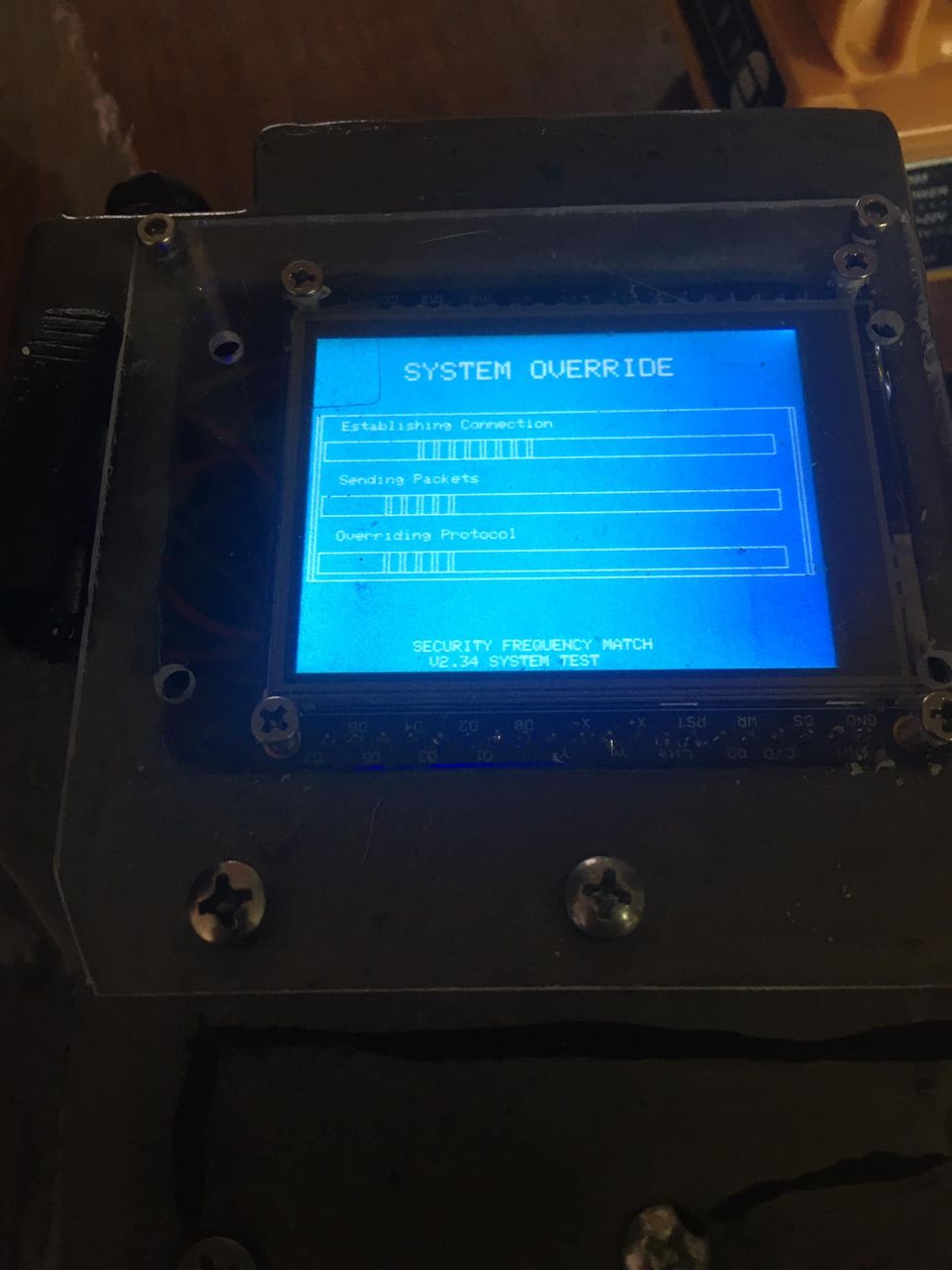

OK, I was busy getting the hardware prototype built. It works fine with an older version of the code sans the state machine piece. Also integrated the hardware for my motion tracker as well.
I will shoot a picture of what that looks like to help
I got the state machine to compile and somewhat run now I just have to sort out the logic and build out the other functions that the state machine references.

void game2() {
  // declare variables for function
  int myHeight = tft.height();
  int myWidth = tft.width();
  int estcon;
  int senpak;
  int ovrpak;
  // sets base text for game
  tft.setCursor(myWidth * 3 / 16, myHeight * 1 / 12);
  tft.setTextColor(WHITE);
  tft.setTextSize(2);
  tft.print("SYSTEM OVERRIDE");
  tft.setCursor(myWidth * 4 / 16 - 10, myHeight * 11 / 12);
  tft.setTextSize(1);
  tft.print("SECURITY FREQUENCY MATCH");
  tft.setCursor(myWidth * 4 / 16, myHeight * 12 / 12 - 10);
  tft.setTextSize(1);
  tft.print("V2.34 SYSTEM TEST");
  calibrate2();
  // the big minigame border
  tft.drawRect(3, myHeight * 3 / 12, myWidth - 9, myHeight * 6 / 12, WHITE);
  tft.drawRect(6, myHeight * 3 / 12, myWidth - 15, myHeight * 6 / 12, WHITE);
  //  bar1();
  //  bar2();
  //bar3();
  int pass1;
  // this rerenders based on button presses
  debouncer1.update();
  debouncer2.update();
  int value1 = debouncer1.read();
  int value2 = debouncer2.read();

void bar1() {
  int estcon;
  // bar 1 override takes reading from slider pot and draws the bar
  tft.setCursor(20, myHeight * 3 / 12 + 5);
  tft.setTextSize(1);
  tft.print("Establishing Connection");
  estcon = map(analogRead(A1), 0, 1023, 10, 295);
  tft.fillRect(estcon, myHeight * 4 / 12, 5, 15, WHITE);
  // redraws left of the slider
  tft.fillRect(9, myHeight * 4 / 12, estcon - 1, 15, TEAL);
  // redraws right of the slider
  tft.fillRect(estcon + 12, myHeight * 4 / 12, myWidth - estcon - 30, 15, TEAL);
  // these are the static vertical lines on the bar
  tft.drawRect(9, myHeight * 4 / 12, myWidth - 30, 15, WHITE);
  tft.fillRect(myWidth - 50, myHeight * 4 / 12, 30, 15, WHITE);
  tft.drawRect(myWidth * 4 / 16 - 10, myHeight * 4 / 12, 4, 15, WHITE);
  tft.drawRect(myWidth * 4 / 16 + 10, myHeight * 4 / 12, 4, 15, WHITE);
  tft.drawRect(myWidth * 4 / 16, myHeight * 4 / 12, 4, 15, WHITE);
  tft.drawRect(myWidth * 5 / 16 - 10, myHeight * 4 / 12, 4, 15, WHITE);
  tft.drawRect(myWidth * 5 / 16, myHeight * 4 / 12, 4, 15, WHITE);
  tft.drawRect(myWidth * 5 / 16 + 10, myHeight * 4 / 12, 4, 15, WHITE);
  tft.drawRect(myWidth * 6 / 16 - 10, myHeight * 4 / 12, 4, 15, WHITE);
  tft.drawRect(myWidth * 6 / 16, myHeight * 4 / 12, 4, 15, WHITE);
  tft.drawRect(myWidth * 6 / 16 + 10, myHeight * 4 / 12, 4, 15, WHITE);
  tft.drawRect(myWidth * 7 / 16, myHeight * 4 / 12, 4, 15, WHITE);
void bar2() {

As folks have requested here is the breakdown of the switch case in the form you all are asking for
  switch (barstate) {
    case bar1test:
      if (value2 == 1) {
        bar1();
      if (value2 == 0 && 220 > analogRead(A1) && analogRead(A1) < 440) {
        passedbar1();
        barstate = bar1passed1;
      if (value2 == 0 && 220 > analogRead(A1) && analogRead(A1) > 440) {
        bar1();
        detect++;
      //      if (value2 == 0 && analogRead(A1) < 220) { detect++; }
    case bar1passed1:

Pictures as stated
I got the logic figured out. I had a typo or math error
        passedbar1();
The "220 > analogRead(A1)" should have had a "<" instead of a ">."
basically the error on my part was the way it was working for all conditions to count as true would never happen as it had to be smaller than 220 and smaller than 440. The desire was to have it be between the values.
The logic. Other than the gamelost screen this is done minus screen finetuning

void bar1() {
  int estcon;
  tft.setTextSize(1);

My bad. Fixed. Will post finished code once I get it completely done.
I Have completed the code project:

void game2() {
  int estcon;
  int senpak;
  int ovrpak;
  tft.setTextSize(2);
  tft.setTextSize(1);
  tft.setTextSize(1);
  //calibrate2(); //turn this on ifyou need to verify you have wiring and settings correct.
  int pass1;
  //  int detect;
  switch (barstate) {

void bar1() {
  int estcon;
  tft.setTextSize(1);
void bar2() {
