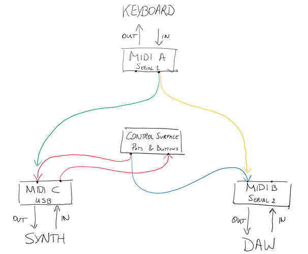

I've done some tests and the MIDI that comes into the RX2 (pin 7) on the Teensy from the DAW is working. But the TX2 (pin 8) is not getting the MIDI data out to the DAW when I play the keyboard. The only way is when I physically hook up the serialmidi MIDI connector IN to the serialmidi2 MIDI connector OUT, then it reaches the DAW. So the MIDI that comes in from the keyboard and the pots & buttons on the controller do not reach the DAW through the TX2 pin.
I thought that with this line serialmidi2 | pipes | usbmidi; that everything that comes in and out of the usbmidi (like the serialmidi IN or the pots and buttons) would be routed to serialmidi2?
Is this how this works?
If I do serialmidi >> RX1 >> usbmidi; then usbmidi >> RX2 >> serialmidi2; isn't the data from serialmidi going to serialmidi2 via the usbmidi interface?
You'll have to draw a diagram with the different endpoints (keyboard, DAW, pots & buttons, etc.) the different interfaces (USB MIDI, Serial1, Serial2) and arrows between them.
Because they're not connected in your code:
To get data from the keyboard (Serial1) to the DAW (Serial2), you need the following connection:
serialmidi1 >> pipe1 >> serialmidi2;
And to get the messages from the pots and buttons (Control Surface) to the DAW (Serial2), you need:
Control_Surface >> pipe2 >> serialmidi2;
No, everything that comes into usbmidi over USB is routed to serialmidi2 and is sent out of TX2, and everything that comes into serialmidi2 via RX2 is routed to usbmidi and sent out over USB.
That doesn't mean that whatever is going out of usbmidi is also routed to the other interfaces.
No, that's not the case.
Is this close to what you want to do?
If so, then all you have to do is make the colored connections:

Note that each MIDI interface consists of two separate halves: for example, the data that enters midiC through the green connection is sent to the synth, but it does not get transmitted over the red connections, there is no implicit connection between the left half and the right half of each of the rectangles in my drawing.
Yeah that's close. Here's the way everything is hooked up:
MIDI A is working, MIDI C is working, MIDI B RX2 from the DAW is working but I can't get data out MIDI TX2 to record in the DAW. The only way I found to record is physically connecting a wire from the MIDI A DIN connector to the MIDI B Out DIN connector and that only records what comes out of the keyboard. The main goal is to be able to record everything that comes from the keyboard & control surface so I can automate all the CC messages.
At first I was thinking that since the synth puts out everything from Notes to CC and SysEx, that I could record / capture what's coming out of the synth into the DAW. I kind of need this because there are a number of Sysex codes for patch dumps, etc...that are triggered by buttons on the control surface.
Since MIDI C is receiving everything that comes from the synth already, (I already use SysEx messages to control the LEDs and LCD) I was trying to connect MIDI C to MIDI B to go to the DAW instead of connecting MIDI A and Control Surface separately to MIDI B. This would work but would not include any SysEx. Hope this makes sense.
Control_Surface >> blue  >> midiB;
doesn't work, nothing comes out of the TX pin no matter what I do. Nothing I send to the TX pins actually goes out, I tried several of the 8 Serial ports on the Teensy 4.1. Not sure what's going on, could the board be damaged?
Well I found the problem, I needed to choose "Serial + MIDIx4" as the USB type. All connections work perfectly. I have to say though, the pipe class in the Control Surface library is pretty amazing and simple once you understand it!
